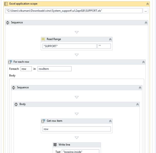

Hi @tovaibhav1
Following steps i have followed for performing my action
1)Initially i had used web recording for giving URL,user_name,password to login into application and navigate to few menus inside application(shown in image1)1 .
2)Then am exporting into excel application
@tovaibhav1
3)then am using excel application scope to read the excel and choosing particular column values to iterate through one by one(ref image 2) .
4)The values in the excel sheet column is used to change password in the web application
5)Then again i use web recording to traverse through sub menus inside web application(ref image 3)
4)Now for the first iteration it is changing password successfully.
For the second time it throws exception while synchronizing with browser
looping inside(write line activity)
P0CT/V001(value from excel)
password changed(write line activity)
P155(value from excel)
Attach Browser ‘UsersResu Page’ : Cannot find the UI element corresponding to this selector:
