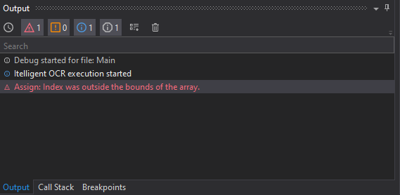

Hello Guys, I had a problem from creating “Intelligent OCR”, to be precise Assign: Index was outside the bounds of the array.
maybe anyone can help me ?
Classification results are null, so it is unable to do substring if you are using
Check once
Thanks
Thank you very much, solved ![]()
