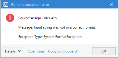

I have an Excel sheet with almost 40000 Rows in it,
I am trying to read the Excel Sheet and using an assign activity I am trying to filter out rows like this
(From r In dt.Select()
Where Convert.ToDouble(r(“Rem Life(%)”).ToString)>70 Select r).CopyToDataTable
But I am getting an Error as :
My Flow :
Does anybody have an idea what might be the issue ?

its about the value that is not parseable into a double by default. This can have multiple reasons e.g. local number format like
1.234,45 vs. 1,234.45
Just share with us some sample data of the datatable e.g screenshot from immediate panel
Hi @Ishan_Shelke ,
Maybe as a First try to also include .Trim
on your .ToString
and Check if it works.
If the above change doesn’t work then you could try the below :
DT.AsEnumerable.Where(Function(r)if(r("Rem Life(%)").ToString.Trim.IsNumeric,CDbl(r("Rem Life(%)").ToString.Trim)>70,false)).CopyToDatatable

same as described here:
[FirstAid] Datatable: Debug & Analysis invalid DateTime Strings / String to DateTime Parsing Issues - News / Tutorials - UiPath Community Forum
We cannot rely on what we do see visually in Excel. So the datatable has to be inspected
similar we can run an analysis in the immediate panel like
dtData.AsEnumerable.Where(Function (x) Not Double.TryParse(x(“Rem Life(%)”).ToString, nothing)).ToList
or others analysis lines
So we recommend to do this analysis as in less then 1 min the issues can be more analysed on the real causing values

The To Trim command worked flawless Thanks
