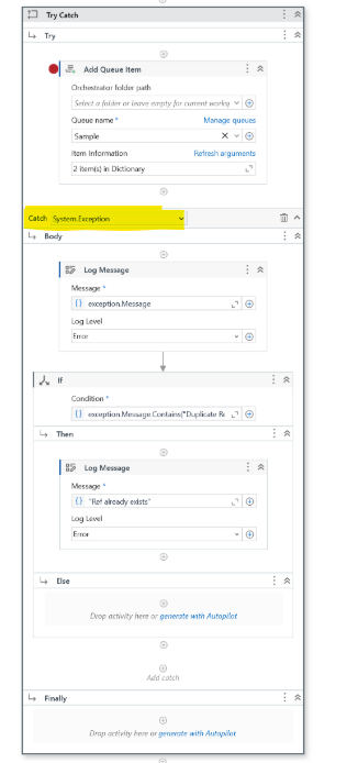

You need to use Add Queue Item activity within Try Catch(Try block)
I forgot to put it back in the try catch; I had positioned it here to get the exception to catch.
I repositioned it in the try but still got the same result.
{02B1B7A2-9321-40C9-BA7A-09EBC5527889}

As i said previously can you please try with System.Exception instead of System.SystemException

You ran in Debug mode click on continue and see what happens..If not worked can you try to update UiPath.System.Activities Package
Great! Thanks for your help.
I updated the packages and ran my test, and the error was caught, even though debug mode doesn’t catch the error.
