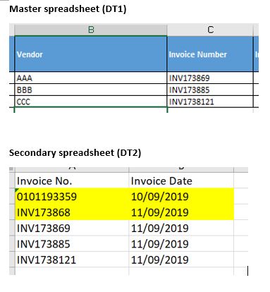

I have 2 spreadsheet that I want to read. if my secondary spreadsheet contains new invoice number that is not in my masterlist spreadsheet. I wan to perform some actions based on the new invoice number.
how do I do it?

here is the screen shots

I’ll suggest you to extract unmatched records seperately and have a datatable of those records, then using for each row on that datatable you can do further process.
For that create one more datatable variable DT3
Take Assign like this,
DT3 =
DT2.AsEnumerable().Where(Function(row) Not DT1.AsEnumerable().
Select(Function(n) n.Field(Of String)("Invoice Number")).Any(Function(x) x = row.Field(Of String)("Invoice No."))).CopyToDataTable()
—> by this you’ll get the datatable DT3 having new invoice no. which is not there in DT1.
So now, by using For Each Row on DT3 you can able to perform required actions.

hi sir,
will this code extract all the information for that row if the invoice is not in DT1?
yeah, its like filtered datatable :blush:. having unmatched dataRows. @Popo
make sure that, column names should be correct in this query.

hi sir, if I have 2 columns (invoice number and invoice date) that I need to compare, how do I edit the code

Okay, If you want combination of invoice number and invoice date to be compare,
Then your query should be like this,
DT3 =
Select(Function(n) n.Field(Of String)("Invoice Number")).Any(Function(x) x = row.Field(Of String)("Invoice No.")) OR Not DT1.AsEnumerable().
Select(Function(n) n.Field(Of String)("Invoice Date")).Any(Function(x) x = row.Field(Of String)("Invoice Date"))).CopyToDataTable()
hi sir
the result is not what I needed.
for example, if DT1 and DT2 contains the same invoice number but have different invoice date, I need the code to extract that row as well.
only when invoice number and invoice date ties, then not required to extract
