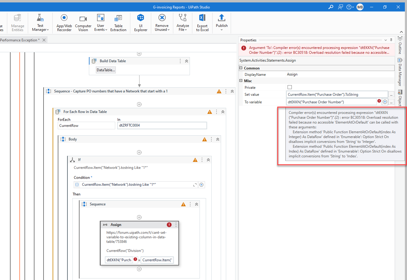

I am trying to write to a data table but getting the below error message
DataTable1 - dtZRFTC0004
DataTable2 - dtEKKN
Scenario
Looking at data table 1, IF “Network” starts with “1” THEN write the “Purchase Order Number” to data table 2
Im thinking the fact that I’m in a ForEach for Datatable 2 is the reason i cant write to data table 1
any idea why dtEKKN(“Purchase Order Number”) wouldnt work???
postwick
(Paul Ostwick)
2
You can’t reference a datatable variable with yourDT(“Column Name”). That’s how you reference values in a ROW, like CurrentRow.
To write to a datatable you use the Add Data Row activity.
