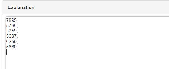

I am woking on a problem wherein i have an excel sheet with 2 columns like below
What i want to do is that i need to write down the second column in a browser like shown below
if some one could help me as to how to approach this problem.

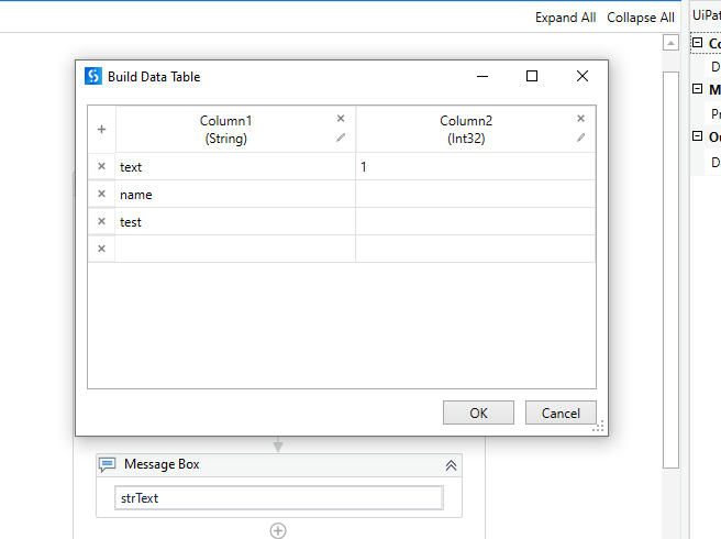

Check as below for your reference
Hope this may help you

Hi @shekhawat.arjun1307
Please use this syntax in assign
strText is string
strText = string.Join(Environment.NewLine,dtTable.AsEnumerable.Select(function(d) d(“Column1”).ToString + “,”).ToArray).Substring(0,string.Join(Environment.NewLine,dtTable.AsEnumerable.Select(function(d) d(“Column1”).ToString + “,”).ToArray).Length-1)
Instead of Column1 use id (It is the column name)
you can use read range activity instead of build datatable activity (as it is for testing purpose)
Yes, you have to use TypeInto activity, the reason i used Log Message is to show you the output
