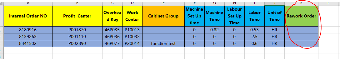

大家好,
请问我有一个EXCEL表格,需要把每行信息录入到SAP中,然后SAP会生成一个PO号需要再写回EXCEL的K列,我用的For Each Excel Row,请问最后Write Cell的公式怎么写呢?谢谢!
要把结果逐行写入K列
Hi @yt.yutao
I think you are using the For each excel row activity to iterate the each row in the excel to grab the values. If Yes, then insert the Write cell activity inside the for each excel row activity and give like below in where to write field.
CurrentRow.ByField("Rework Order")
Check the below sequence for better understanding.
Hope it helps!!
