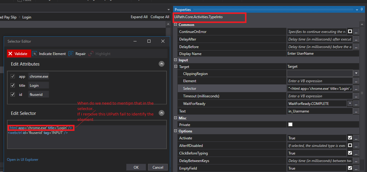

When we use Attach Browser activity and define the scope for the activity with in that why do we still need to use “” text in the selector fields of all the activity?
I tried to remove that line from the selector and element fail to identify those element

I think i did not explain my query properly.

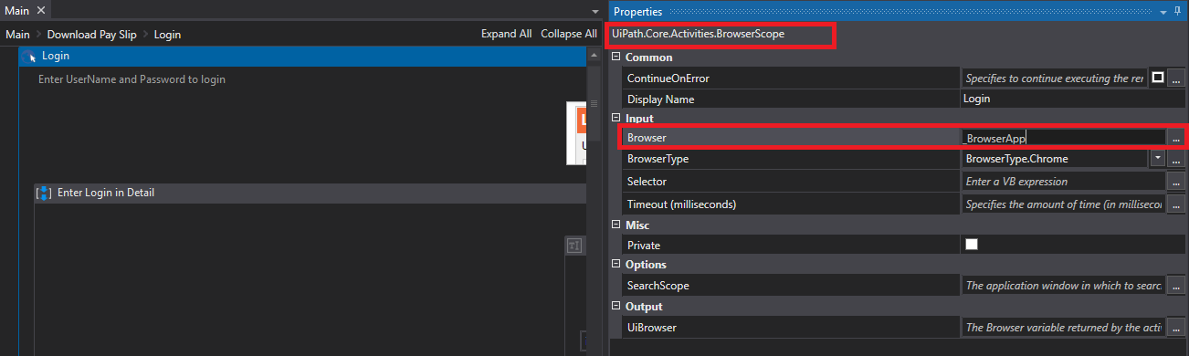

I have used Attach Browser activity and in Browser property i have provide existing browser variable that i got from Open Browser activity.
Now with in this activity i have used TypeInto Activity to enter some thing.
My question is why in Selector i need to mention “” . If i remove this line UIPath fail to identity the element.
The purpose of using Attach Browser was i have other instance of chrome running in task. manager, so according to doc of Attach browser it will attached to the instant that we provide and Attach Browser perform the action with in that

In the attack browser there is an option for output variable. If you populate it you can use it another attach browser activity
