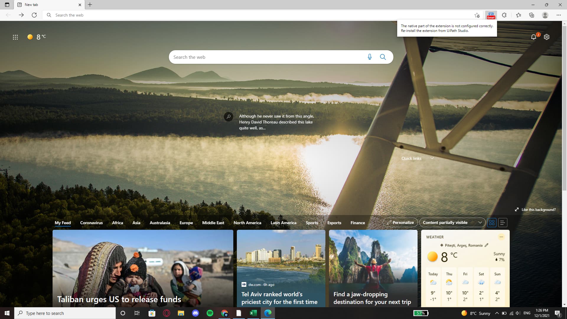

Hello guys! Please help me with this thing! Chrome extensions seems to be installed (did it many times). I don’t know why I get this error. Thanks!

I also get this message in Microsoft Edge:
But don’t know how to reinstall…did it many times as the previous screenshot says, I have no idea

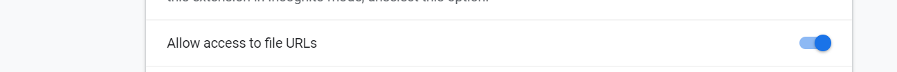

Enable Allow access to file URL option on the extension pls.
Yep. I did. But without results

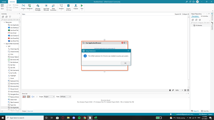

I tried again from 0, and even though I have installed many times Chrome extension (see above), it still shows this:
If I press install, do all things and it shows that it has been installed, but after I try again, it shows the same like in the screenshot

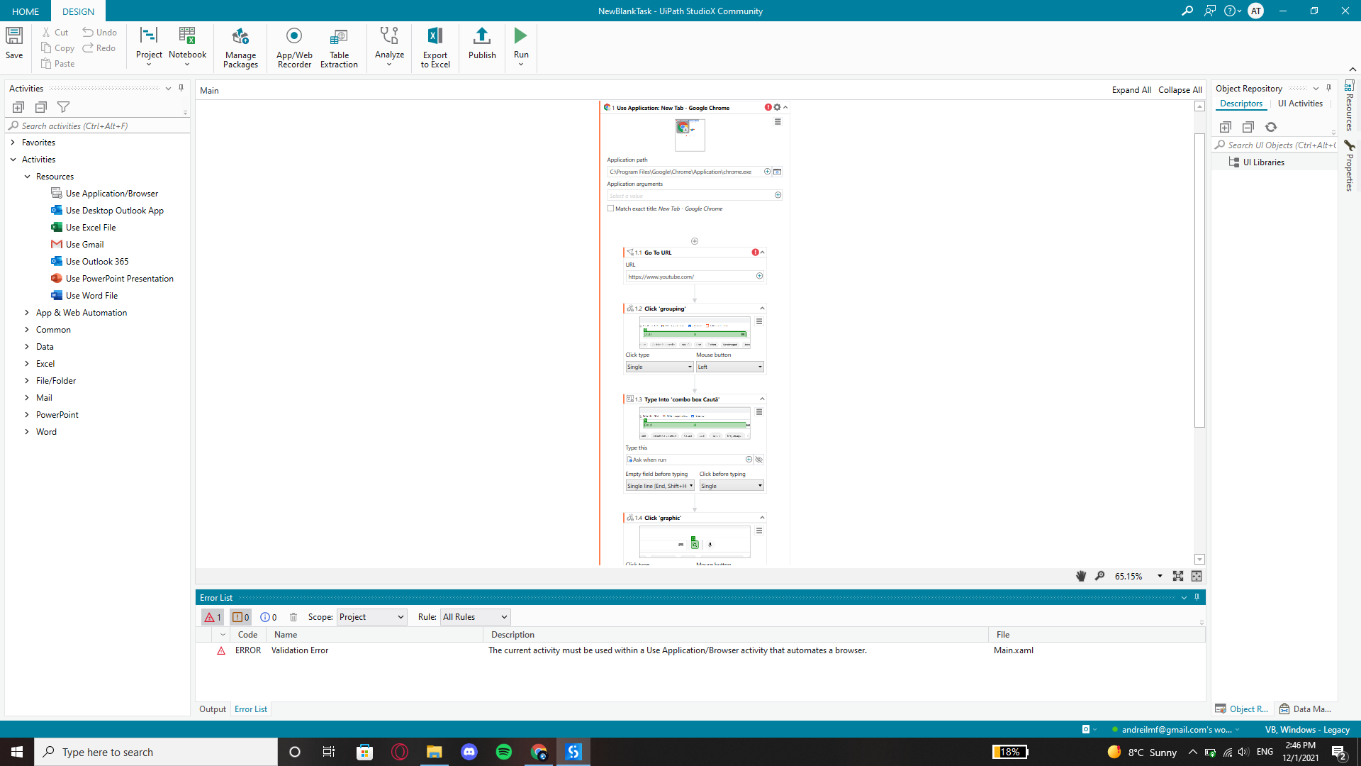

As per the screenshot why can’t we use https:\www.youtube.com in the application path or URL so that we no need to use go to URL activity.
in the screenshot Go to URL activity only creating some issue.
