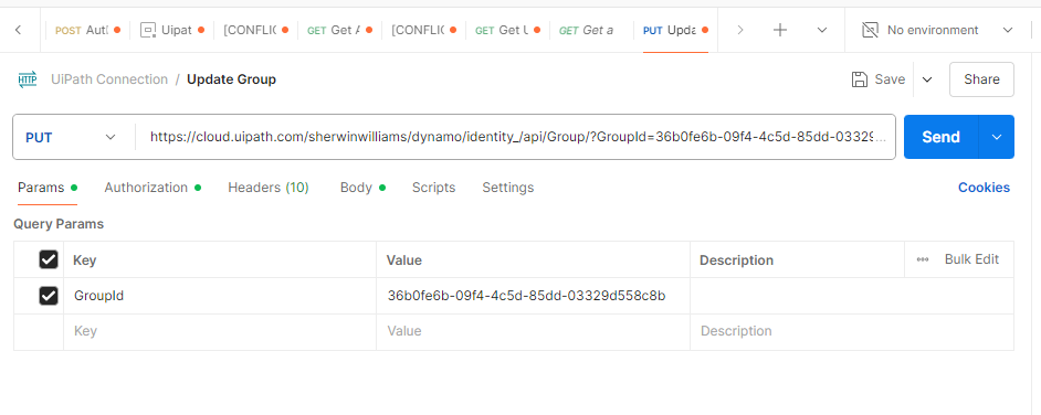

I am having issues with using the Update Group API in Postman. provided Global partition ID , Group ID as parameter and group name , User Id (email id of the person) . Receiving 200 ok but as per the documentation it should be 201 ok when the user added successfully. Can someone please help with this ?

Could you please check the group id again? This doesn’t look like group id to me, should be only digits and most likely under tag “Id” within a group info block.
Also please check the endpoint again.. I see ? Sign and groupId literal in your endpoint..

Thanks for your responses. The one it is showing in the screenprint is not group id , its GlobalPartitionID. As per the documentation , Group ID is provided in the parameters.
The Put api call url i used is //cloud.uipath.com/{organizationName}/{Tenant}/identity_/api/Group/{GroupId}

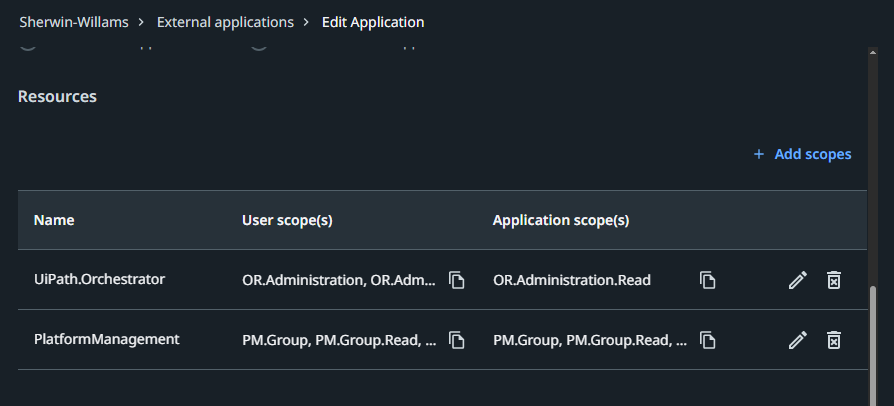

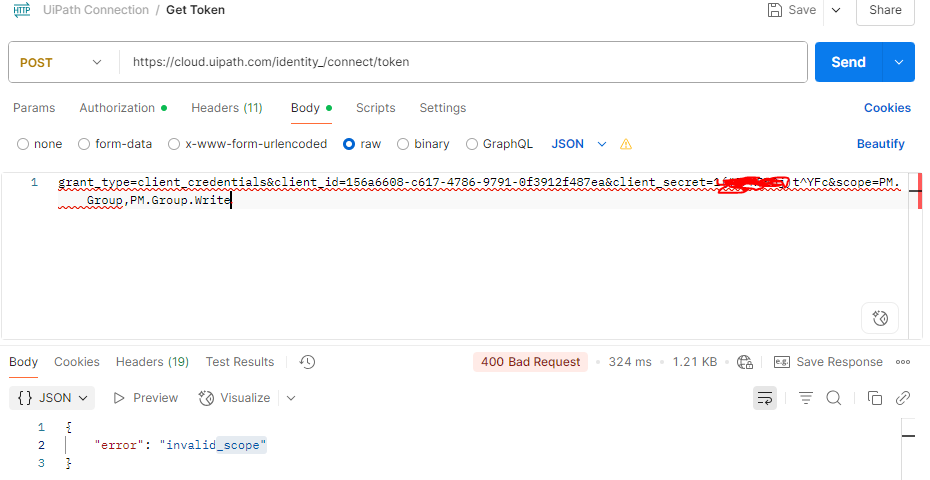

Thanks for your response. I followed your instructions and it is not accepting the scope specified. I have checked the external applications platform permissions as well.
Could you suggest any more solutions on this ?
Hi @radhika_tadiboyina
Kindly remove the PM.Group.Read from external permissions scope and then retry,
I see you have added all 3 scopes there - PM.Group, PM.group.read, PM.Group.Write
Please note that all 3 scopes can not be selected at any given time for any of the api access, it throws invalid scope error.

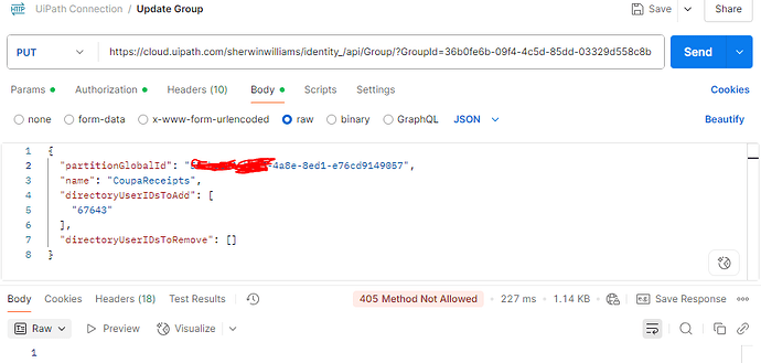

Thanks. I removed PM.Group.Read and tried it with only PM.Group.Write permission and got the token. Update Group api call is throwing 405 method not allowed error.
Your endpoint URL doesnt seem right for PUT operation.
It should be only like below, no parameter for this operation:
https://cloud.uipath.com/{your org name}/identity_/api/Group/{your group id}
