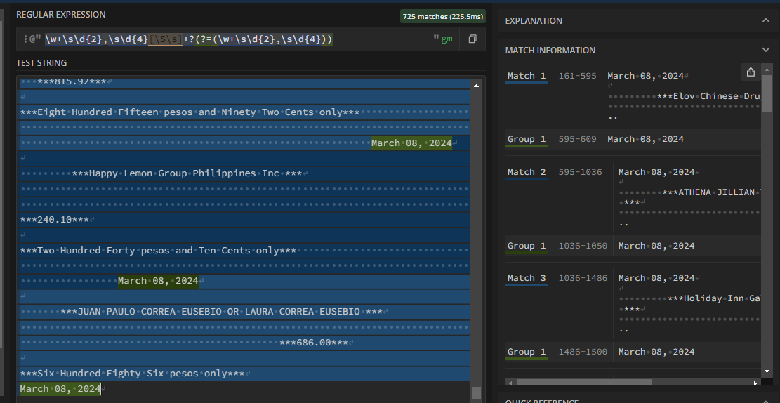

As mentioned earlier, to conform with the Data pattern retrieval, we add the dummy value.
From the below, we can see that the last Set value is not being retrieved with the regex pattern used.
But adding the end dummy pattern below would allow us to retrieve it as well.
However, from the result, the last date value is not retrieved as shown in the result.
