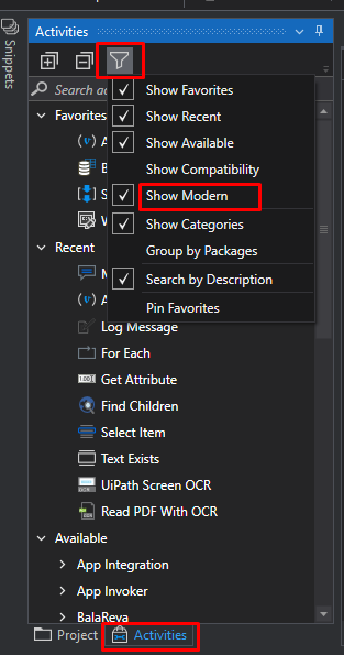

Hi @mairin
For Using Modern activities, Just enable the option in the filter
You can use 22.4.5 or higher 22.10.3
