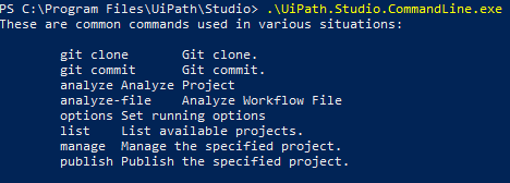

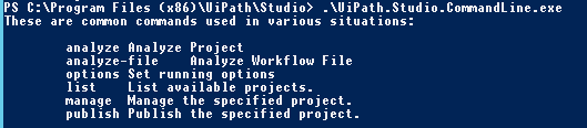

I came to this conclusion in the following way: If I type the UiPath.Studio.CommandLine.exe command in the development virtual machine, the TFS commands are listed. And when I type the same command in the production virtual machine, they are not.
Development VM:
Prod VM:
Note: Both are in the same version.
Development VM:
Prod VM:

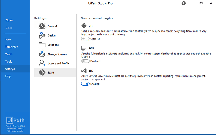

I just found out that commands are only listed for enabled source control plugins
