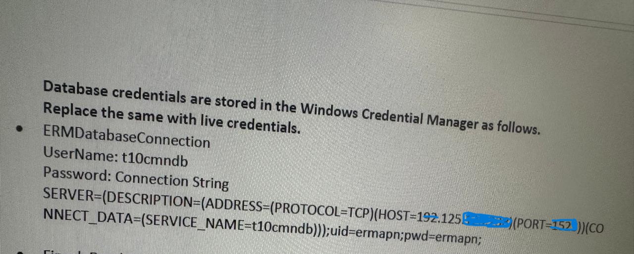

My current setup:
  • Oracle Instant Client 19c installed
  • Connection string:
SERVER=(DESCRIPTION=(ADDRESS=(PROTOCOL=TCP)(HOST=192.168.###.##)(PORT=1521))(CONNECT_DATA=(SERVICE_NAME=TEST)));uid=ermapn;pwd=ermapn;
  • Provider: System.Data.OracleClient (default in Database Connect activity)

HI,Mir.Jasimuddin
I followed the provided instruction to configure database credentials in UiPath.
Earlier we were on Oracle 10g, and now the DB has been upgraded to Oracle 19c.
I used the same hostname, port, and service name as before.
Connection string used:
But now I am getting the error:
System.Data.OracleClient.OracleException: ORA-12557: TNS:protocol adapter not loadable
