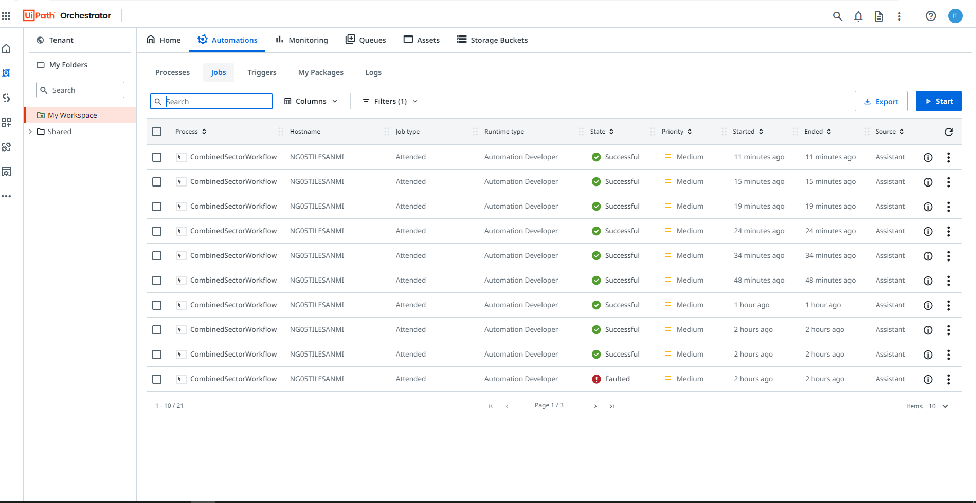

I am running it directly from UiPath assistant and not orchestrator. It ran successfully but no error messages. I already stored the output file on C drive as you directed. I am still able to generate the output from studio but when i run from UiPath assistant its runs successfully from UiPath assistant but no output message on the output file
screenshot of the log file i downloaded from orchestrator
and this is the screenshot from orchestrator
I have resolved it . I was publishing the process to a wrong workspace.
