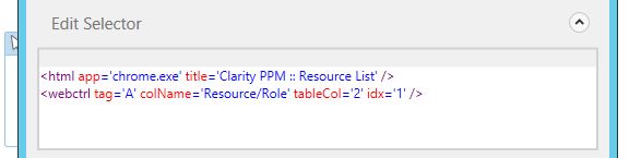

can you create custom selectors ? go to UI explorer and show all selectors

check aaname , innertext and uncheck idx & tablecol
