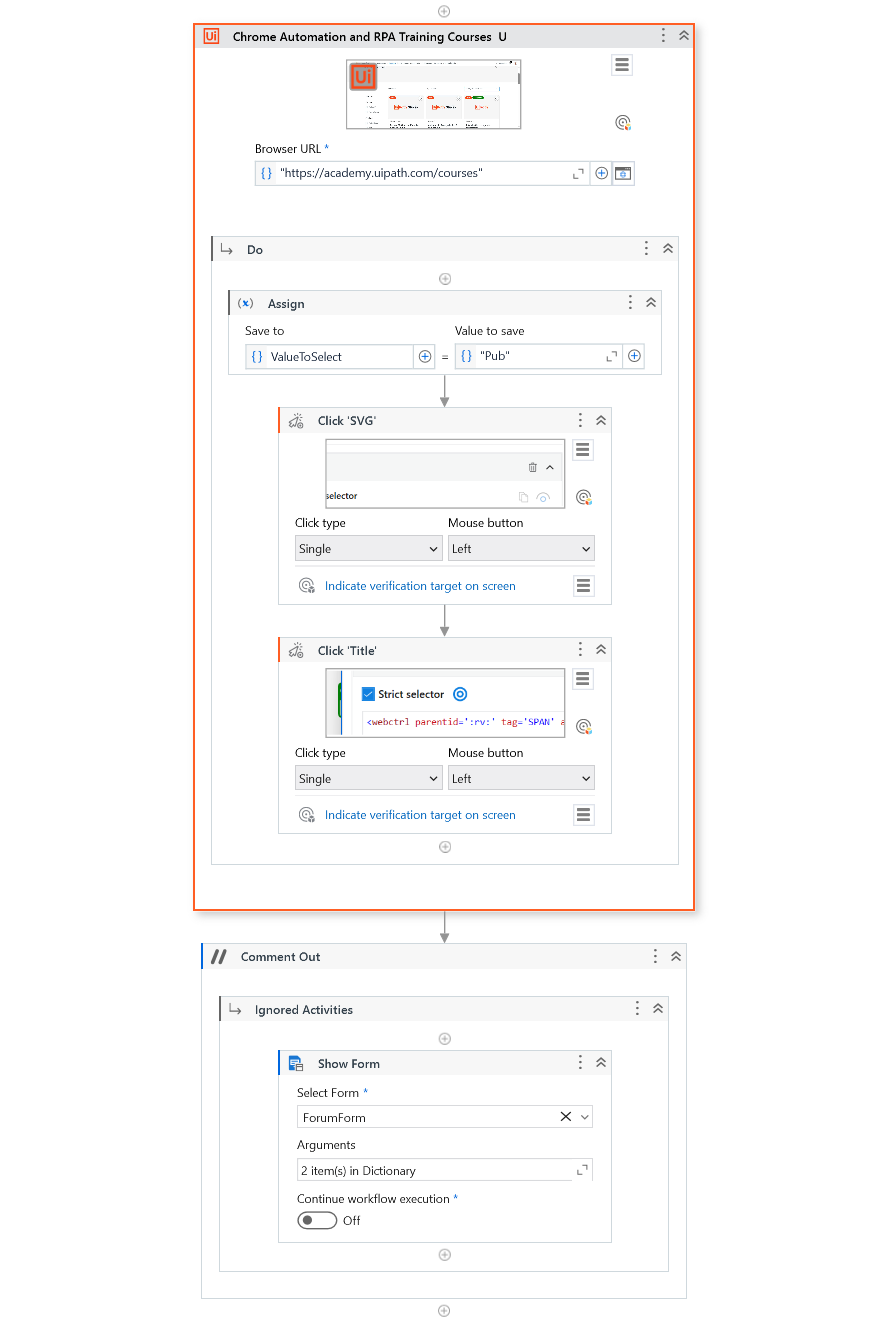

Try to achieve using 2 clicks instead of going with Select option
Step 1: Assign the value you are expecting to select into a variable. As mentioned - only the static value in the drop down
Step 2 : Click on the drop down arrow
Step 3 : For development - select any drop down value and keep the option as strict selector. Make sure the drop down value like inner text or AA name is included in the property
Step 4: Modify the selector to make it dynamic
Refer attached workflow created for public academy site and modify the selector accordingly
ForumProject.zip (800.3 KB)
