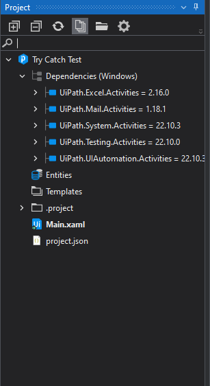

@Yoichi, Not sure I understand what that is, but here is a screenshot of the project panel.
HI,
There seems no GlobalHandler…
