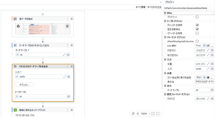

Firstly, I believe the above is not syntactically valid. At the very least, it is necessary to convert what is stored as a string into a numeric value.
If all the column values are numeric, there may be a method like the following using the functionality of the GenerateDataTable activity.
