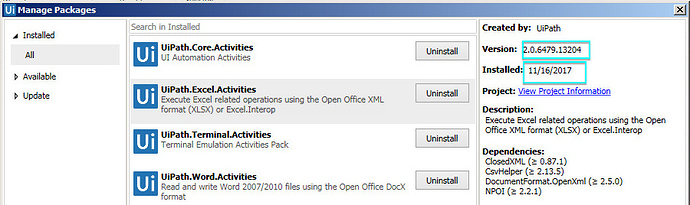

we have not launched a new excel package recently, so i doubt that you got updated today but still, can you send me a screenshot like this:
