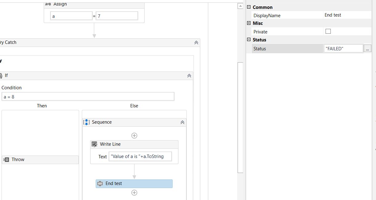

I am attaching my example, not sure why I am getting the result as “PASSED” instead of “FAILED”.
Thanks
simple_try_catch.xaml (6.5 KB)
Please use the end test activity inside of THEN block of IF
Then your report will show, as FAILED

Hi @mzahid,
in the xaml you sent to me,
if you change the condition to a<>7, it does not work.
