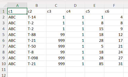

this is the table text extracted from a PDF, i need the output for this as below image in a single DT.
**Note: some PDF’s table text will be for only one page and in some PDF’s the table will be in multiple pages,The given input pdf is having 3 pages of table for the reference. After extracting the text, in between the table data "Output Report ******* page *
–Table of Contents-- " is existed .

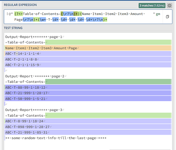

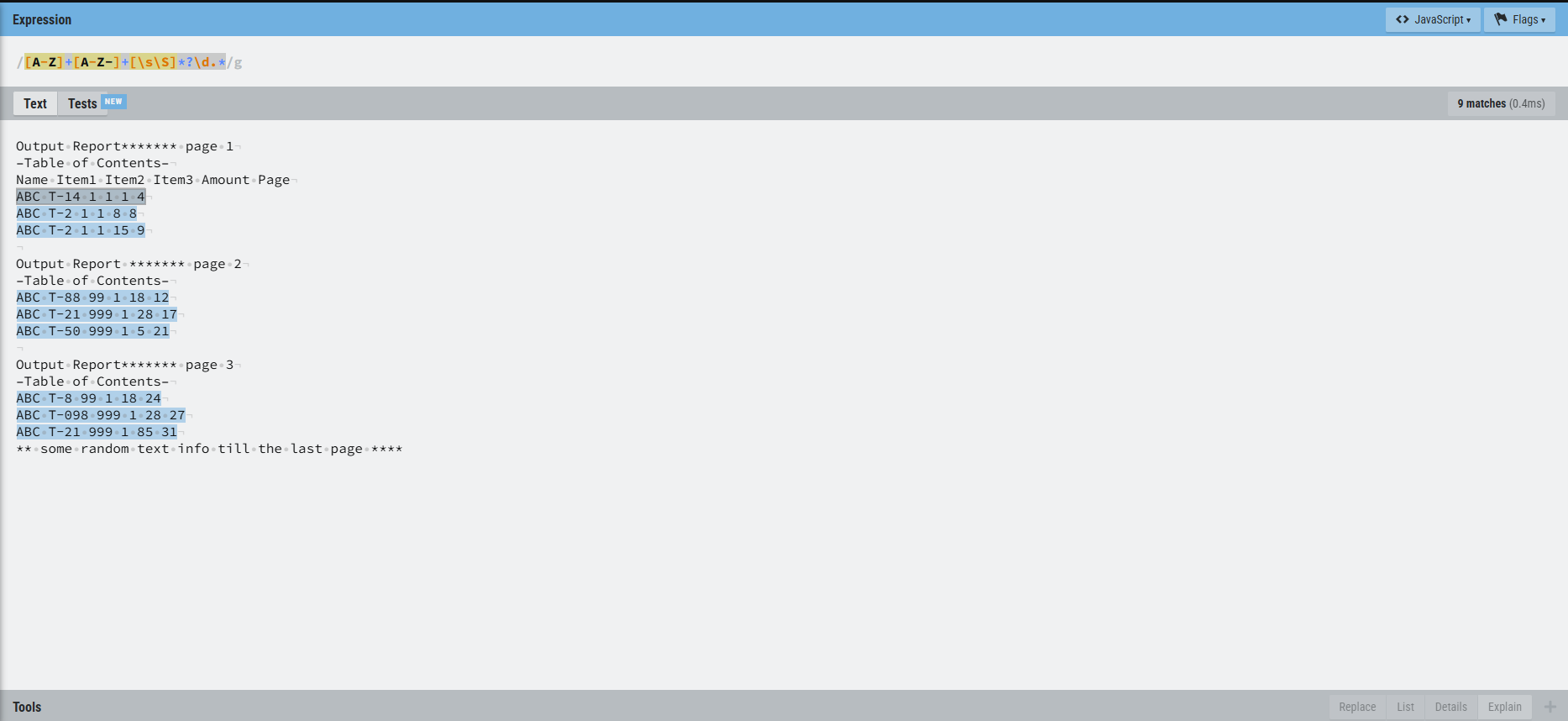

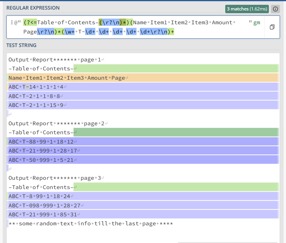

firs thing what did you do for one page?
ideally if know what would be there in end then its easy to remove the random text
and then coming to extraction looks like regex would work for this
a sample is here refine as needed but logic remains same
(?<=Table of Contents–(\r?\n)*)(Name Item1 Item2 Item3 Amount Page\r?\n)*(\w* T-\d+ \d+ \d+ \d+ \d+\r?\n)+

@kmaddikatla
Please try above regex and get the data then, as mentioned if needed modify the regex as per your requirement and then use the same generate table

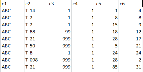

Hi @kmaddikatla
Please check the below workflow file, let me know if any changes required
Sequence1.xaml (13.0 KB)
Output:
Hope it helps!!
