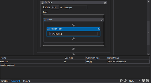

Following is my UiPath code

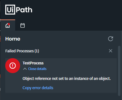

but when I click on the button and the job starts, it gives me the following error
error

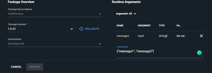

When I set the argument in orchestrator and start a job through orchestrator, it works fine
