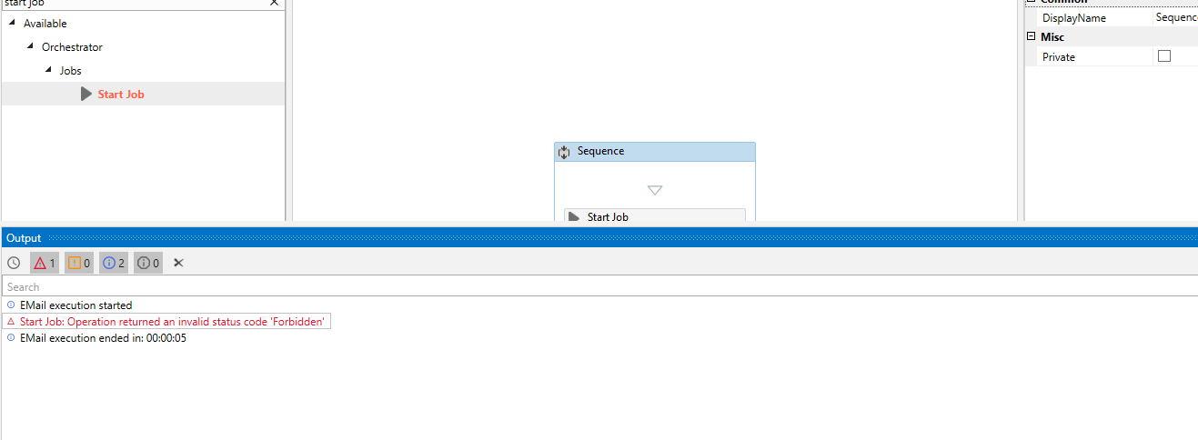

Hi team,
Am getting the below error, while am trying to run the job using this activity,
Can anyone help in this, how to resolve it.

What process is the job trying to run?

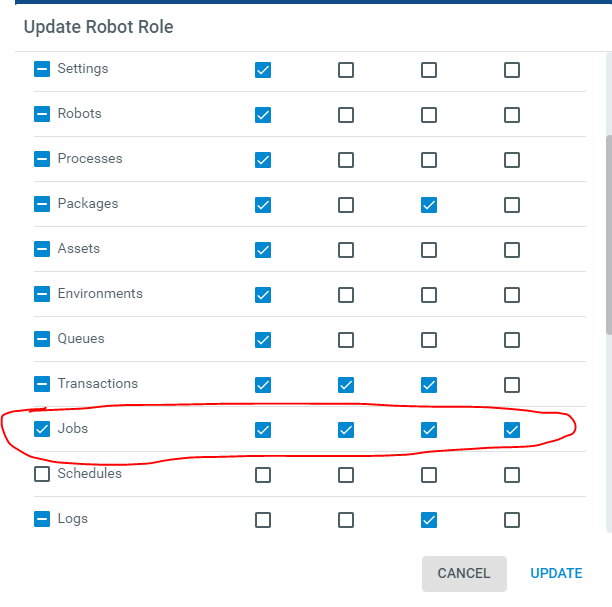

I came across this error before when trying to run a process to raise an Alert, I solved it by adding the robot to the administrator group.
There should be an option to view Roles, if there is not already an admin Role you can create one.
You will be prompted to give the role permissions to View, Edit, Create, Delete etc. Select the permissions you need to run your process and add your robot to this role using ‘Manage Users’.
I would not recommend to add the robot to the administrator group because it should not have all the permission a administrator user should have. Robot should only have the permission required to execute its jobs. It is recommended approach for security purposes…
So what you can do is, you can edit the robot role in the Orchestrator to enable job execution.
This will fix your problem.

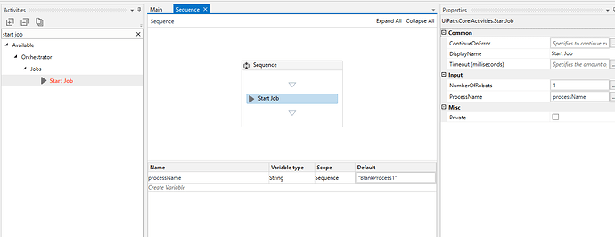

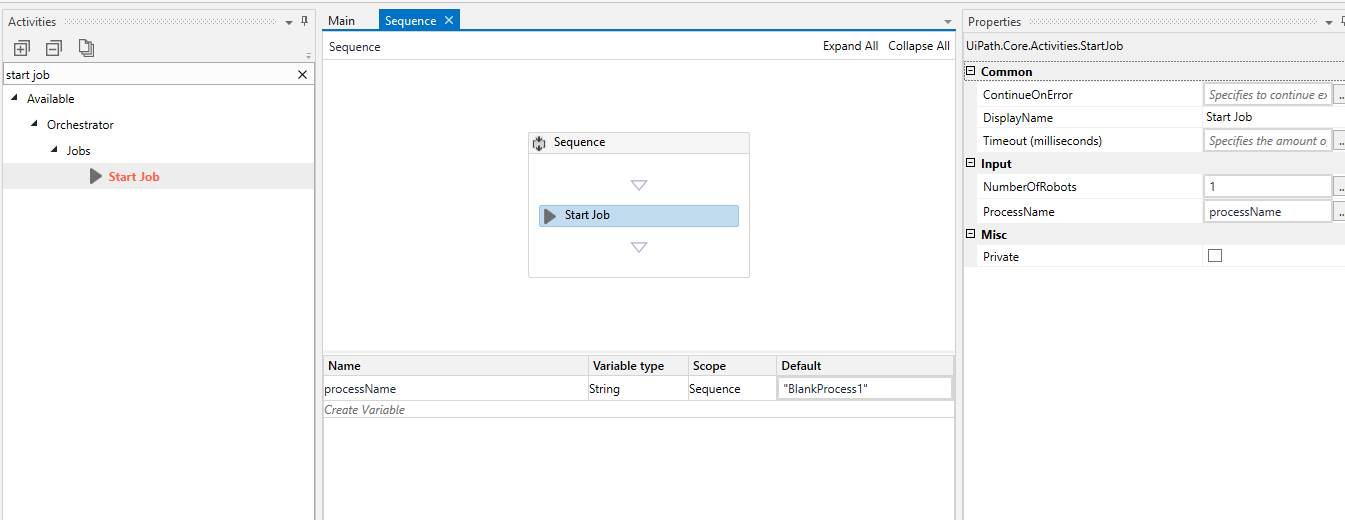

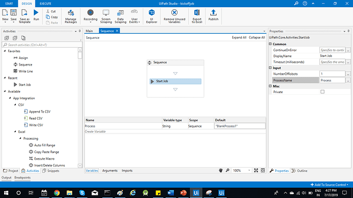

hey thanks much for the reply. even I did all the settings above in orchestrator, getting the same error. The below is the program,

Am still getting the same error! should I do anything apart from editing in the orchestrator?
Disconnect the robot from the Orchestrator and connect it again and see… it should work

Also make sure you have the robot role configured to have “View” permission for Processes and Environments
The permission looks fine @sushmithaelluru
However, I notice something i your default value of the process variable. The job to run should be in "_ format.
Try change that and see whether it works…
Hey @Lahiru.Fernando, it worked now. But how can I see whether that job ran or not?
