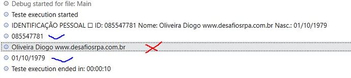

I extract it from a png file by using the activity UiPath Document OCR . I have to store the numbers after ID:, the name after Nome: and the date after Nasc.:
The ID and the date I can get correctly as you can see in the output panel, but the name I can’t. I don’t want the website address.
To get it I’m using this: img_STR.Split("Nome:")(1).Split(" Nasc.:")(0)
