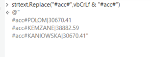

inserting line break
grafik

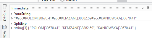

Hi @murat.karasoy
How about this expression?
Array(String) = YourString.Split({"#acc#"}, StringSplitOptions.None).Skip(1).ToArray
