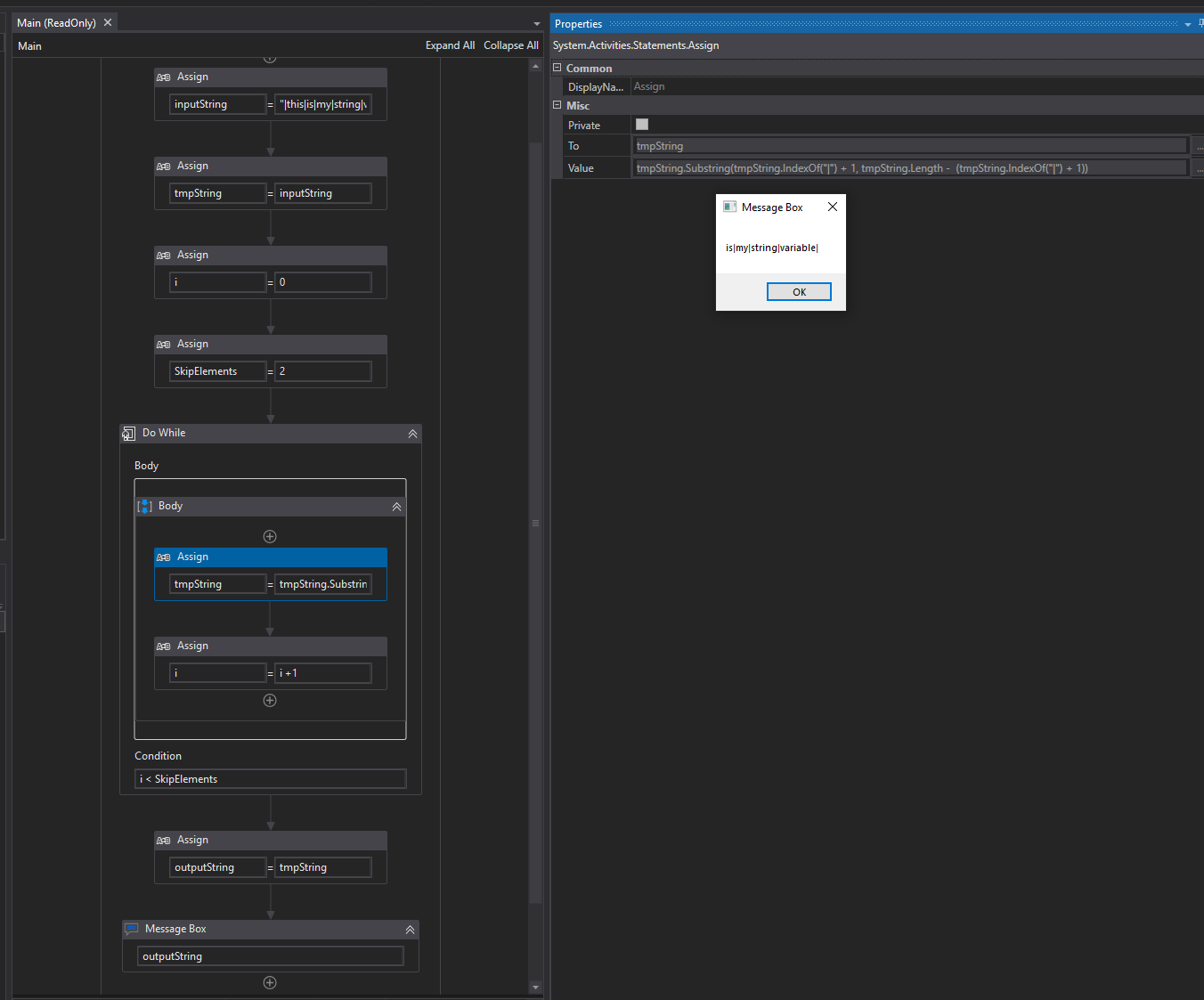

just to confirm: is your desired output ‘is|my|string|variable|’
we are going to expand on the response from @Srini84 with this solution (we will be having some fun with the substring command with a bit of nesting in between!)
Main.xaml (7.9 KB)
@cssc please take a look at this and let me know if it works for you
Input - ‘|this|is|my|string|variable|’
output - ‘is|my|string|variable|’
One last thing- We can try to use some combination of the Split Take and Join Commands to put all of this in a one liner. I’d be very interested in putting that together if you want.
