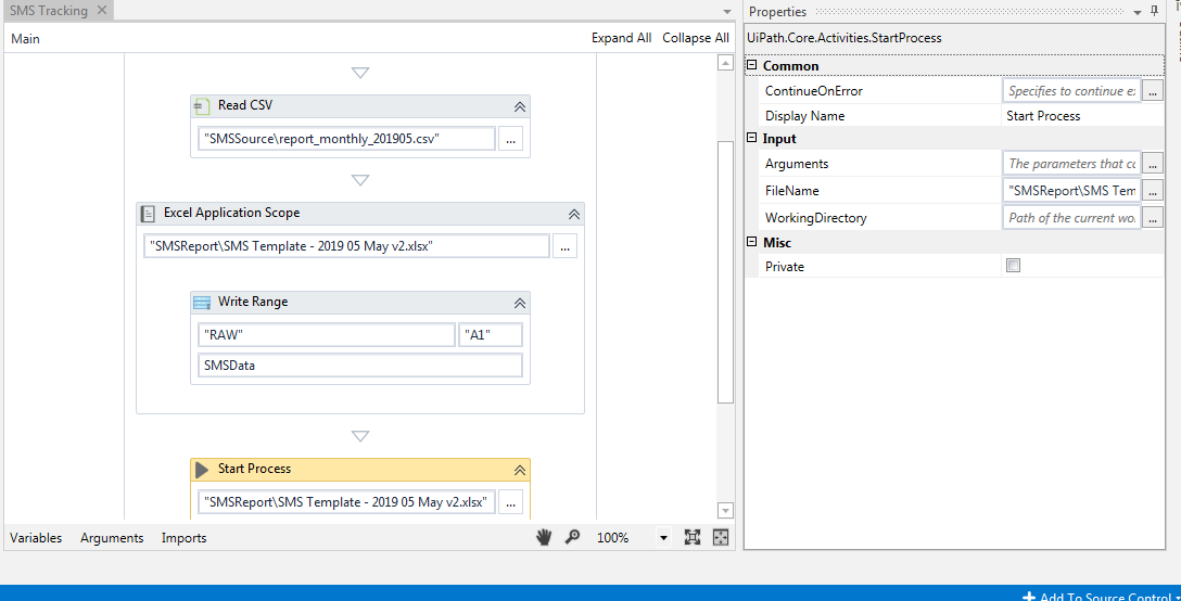

This is all I’ve done so far … pathetic I know… so the “Read CSV” Activity is supposed to somehow capture the data inside the file once I click run, and the pathing in my “Start Process” Activity is the destination file.

Not too sure how would start process works, currently i’m up to here

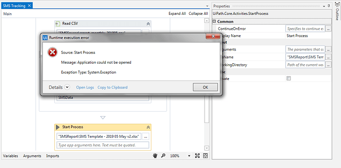

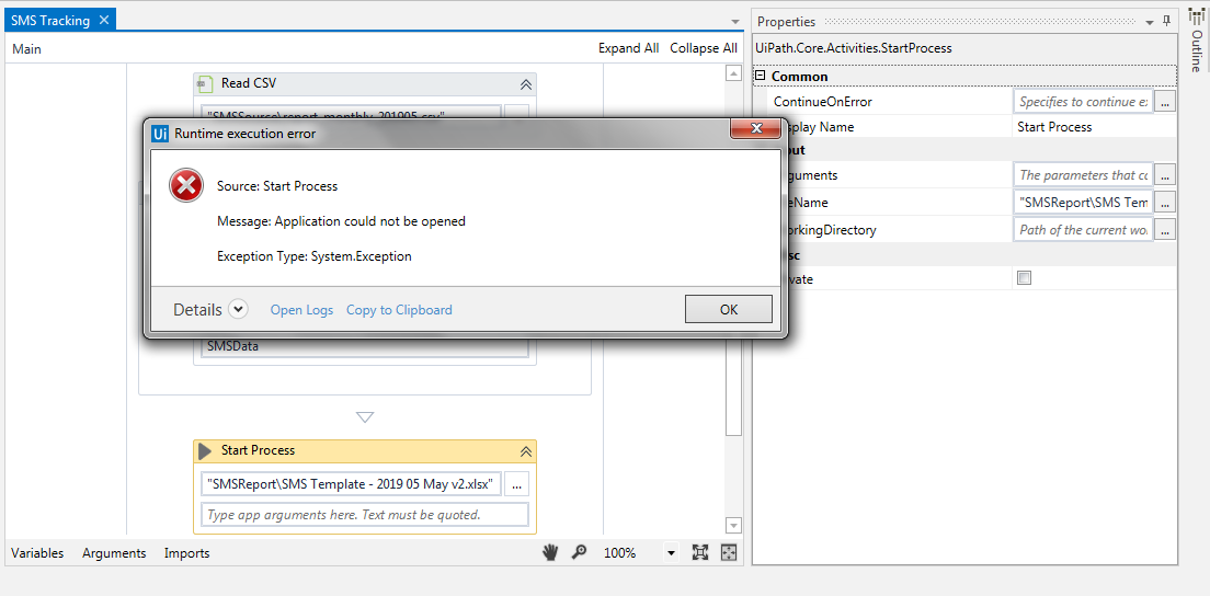

At one point this displays when I run it, an error displays
Not sure how to go about it, i’m not too familiar with using macro as well, not sure how the language goes and how to come up with an instruction to do what i’ve mentioned earlier
@RPALearner93
In start process Activity, you have to specify the entire file path of Excel under filename property to open it.

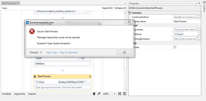

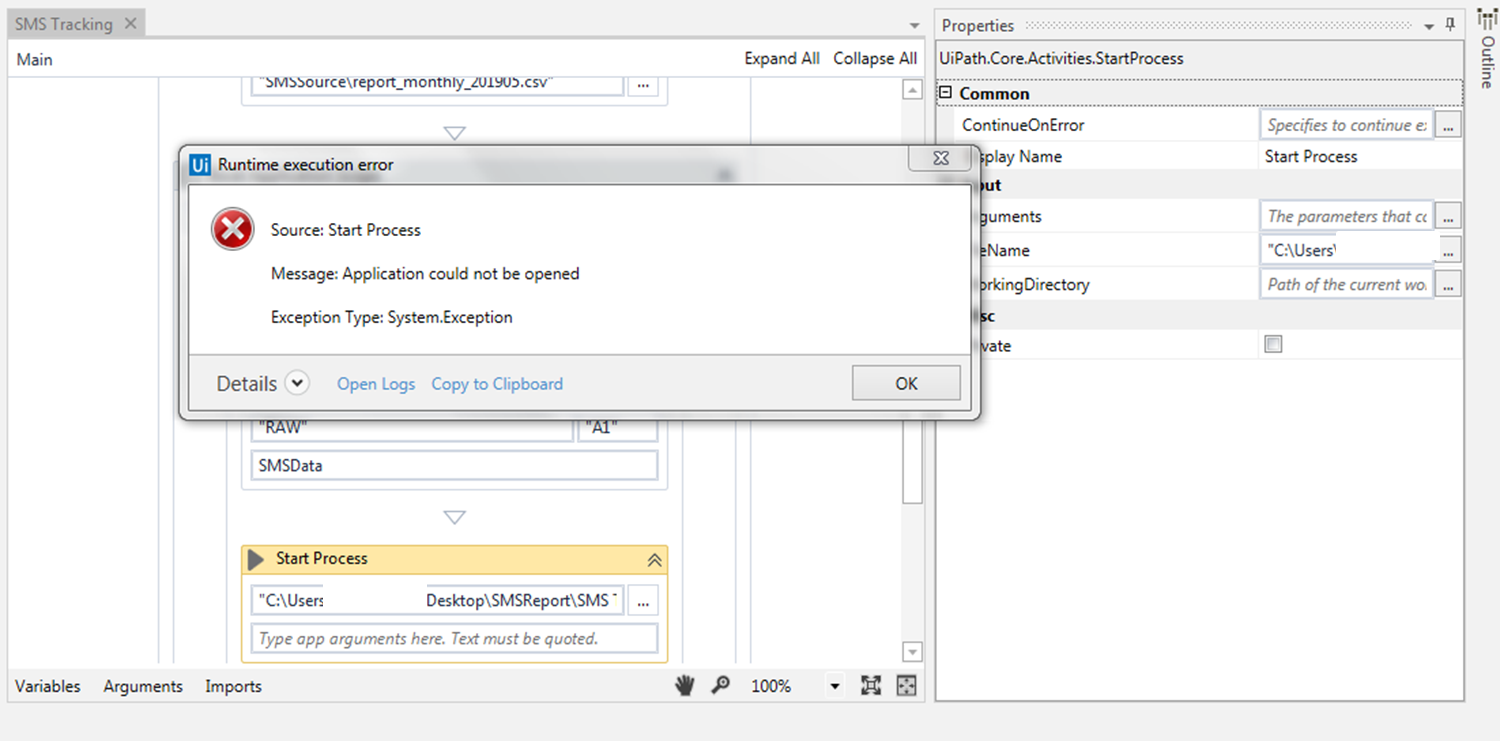

Hi as you can see I’ve included the entire file path but it is still displaying an error DESPITE the file opening.
Here is the expression editor
Buddy use a KILL process activity before start process and mention the process name as “EXCEL” in kill process activity
Cheers @RPALearner93

I’ve tried to input a kill process activity after the “Write Range” (Copying and pasting from one excel to another) and in the Kill Process Activity, I’ve input to the process name to kill “Write Range”, I tried to run it and ultimately it does the copy and paste but still ends in an error, what am I missing here?
@RPALearner93
Check filename properly in Start Process activity. Here, you passed like “SMS Template - 2019 05 May v2”. I guess it is incorrect. There is no extension to this file. you have to specify absolute file path here.
Hi Buddy @RPALearner93
You were almost done…the thing is the input been passed to start process under file name property is not correct…we need to pass the EXCEL FILE name with .XLSX or .XLS extension like this
“SMS Template - 2019 05 May v2.xlsx”
That would work for sure
and make sure that you have mentioned process name property in kill process as “EXCEL”
Kindly try and let know buddy @RPALearner93
