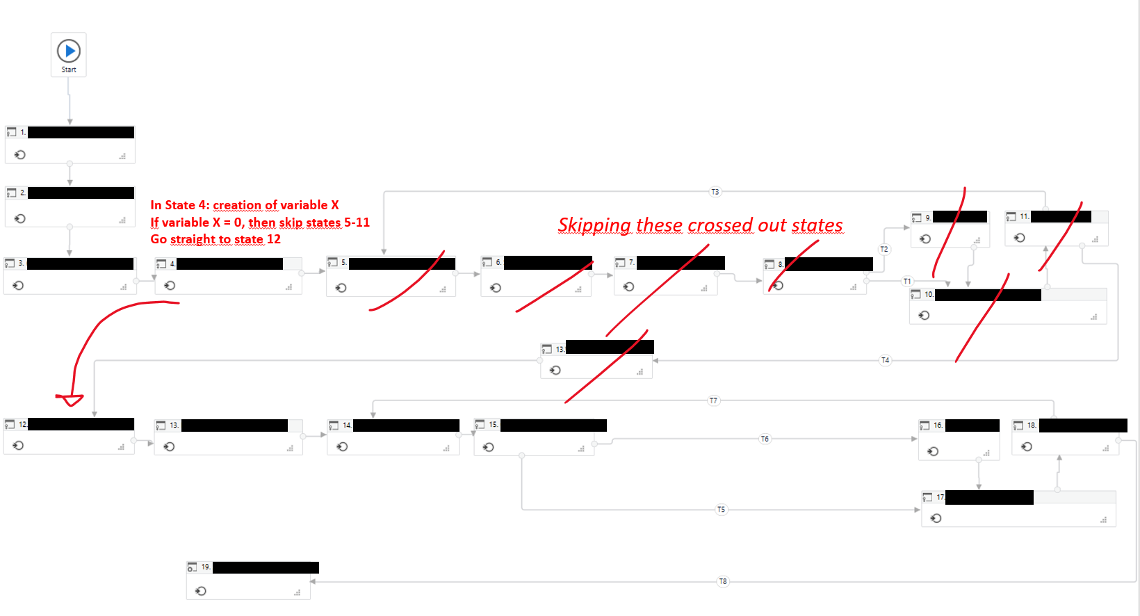

Below you can see how my state machine bot looks like.
In State 4, I am creating a variable that counts certain entries in a table. If those entries are = 0, then the bot should skip states 5-11 and directly continue with state 12.
Could somenone kindly advise me on how to implement this?

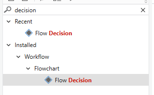

Hi @Anonym ,
As it is a Flow chart setup, you can try using the Flow Decision activity :

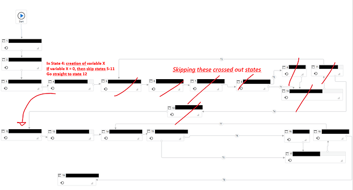

@Anonym
In your statemachine transition condition use x=0 for the transition from state 4 to 12
For state 4 to 5 use condition as not x=0
