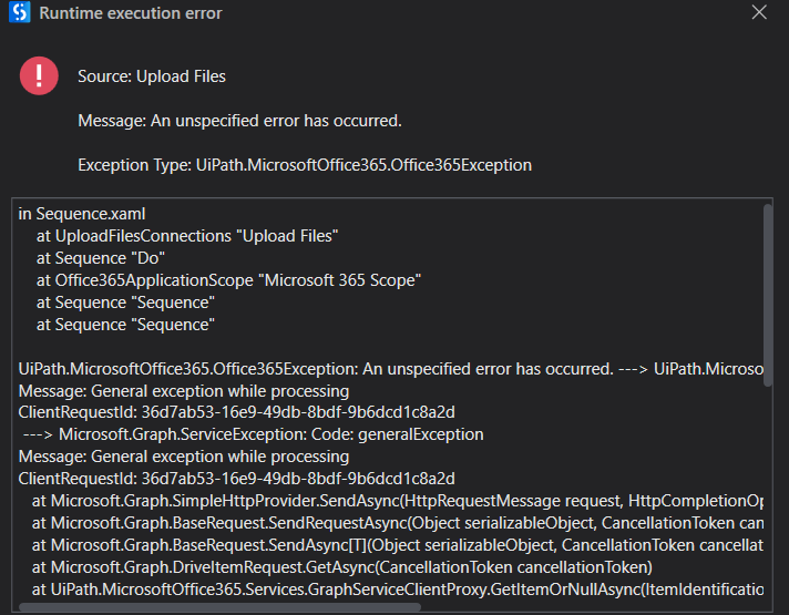

I am currently facing issue with sharepoint upload file.
For authentication : Using Application ID and secret key..
Any idea how we can solve the issue.

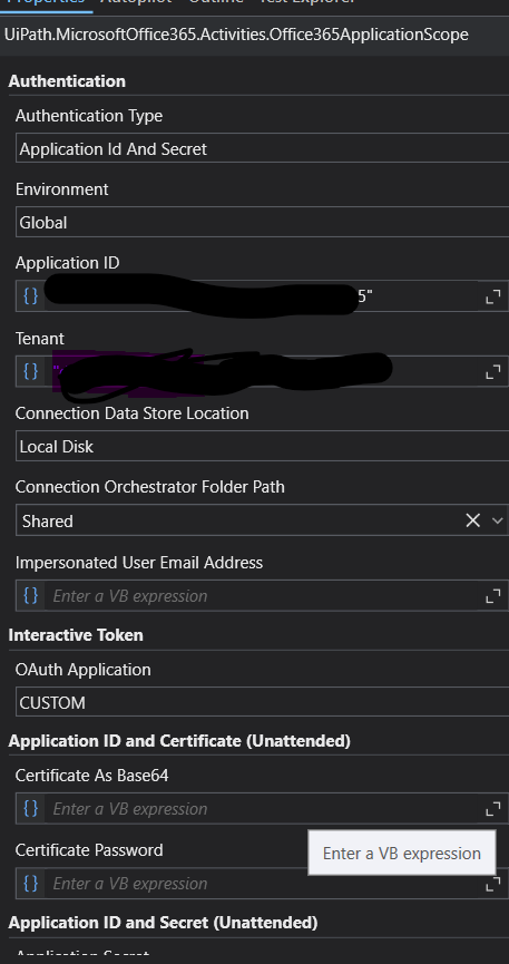

Yes i am passing all three value , App ID, Secret key and tenant id.

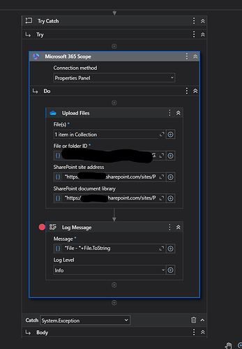

bot Flow →
Azure app permission :-

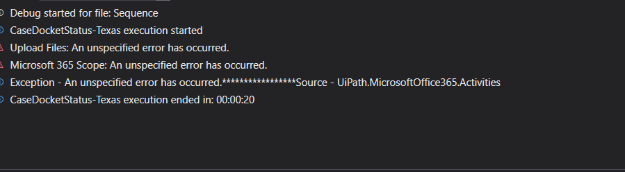

@ashokkarale : Exception message.
General Exception typically means that your authentication isn’t working.

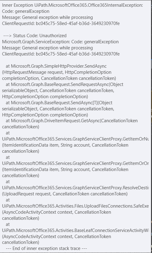

@AJ11,
Can you try getting innerexception. Let’s see what it is
exception.InnerException

Also, I see you are using upload files activity instead of upload file. Are you trying to upload multiple files to the SharePoint?
Please confirm that the file to upload is in iresource type format and folder/file id used in properties is correct.
Else you can also simply try to use upload file if you are only looking to upload 1 file.

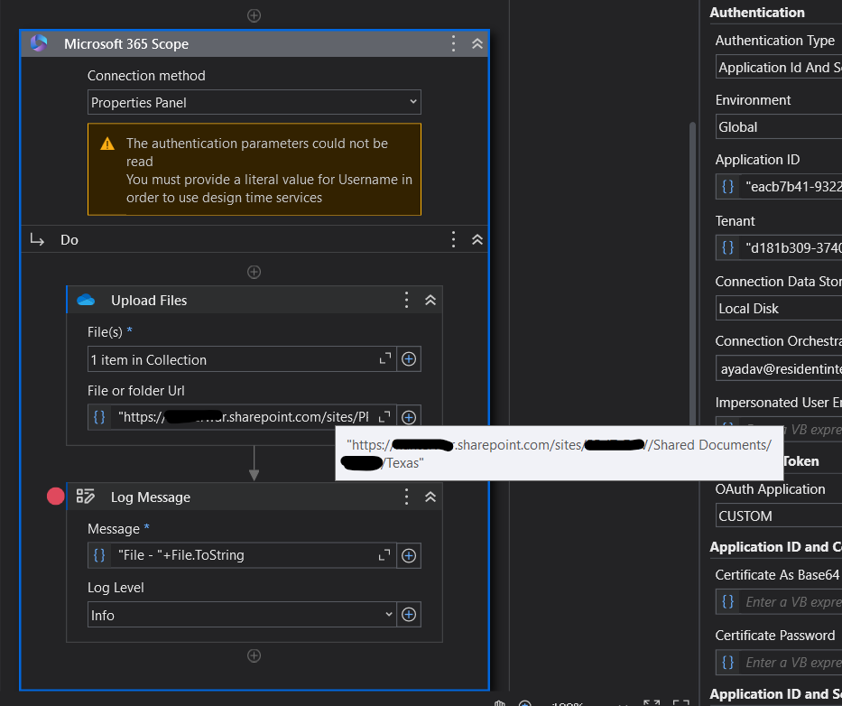

I am getting different exception for different type of authentication .
For Interactive token its working fine. bot is able to upload the file to directory.
  1. For UserName and PAssword exception -
  1. For Application ID and secret key -
Bot workflow -
Not sure what configuration is missing…

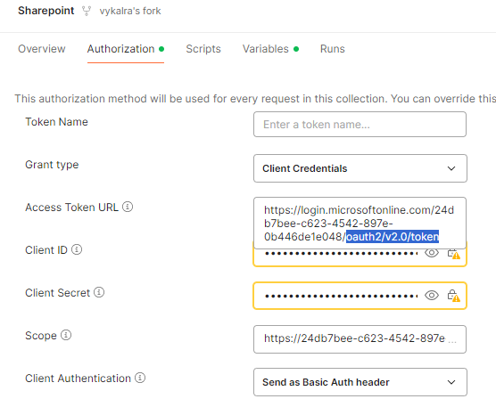

Does this work if u try to invoke the token API via Postman?
@Vishal_Kalra Can you help me with steps ??? how to invoke with postman.
Please refer to this steps
Sample that I use:
Thanks @Vishal_Kalra for steps, But right now i don’t have postman in my system. And For installation its will take time. Is there any other to validate ?
I usually try postman to validate stuff first. You can try the web version of postman too ( which does not require the installation)
https://blog.postman.com/announcing-postman-for-the-web-now-in-open-beta/
You’re using the UiPath Azure app instead of your organization’s custom app. Change the pulldown in the Scope activity from UiPath to Custom.
Issue is resolved now, exception was thrown because admin consent was not provided. After admin consent its working fine.
Thanks every one for the help.
