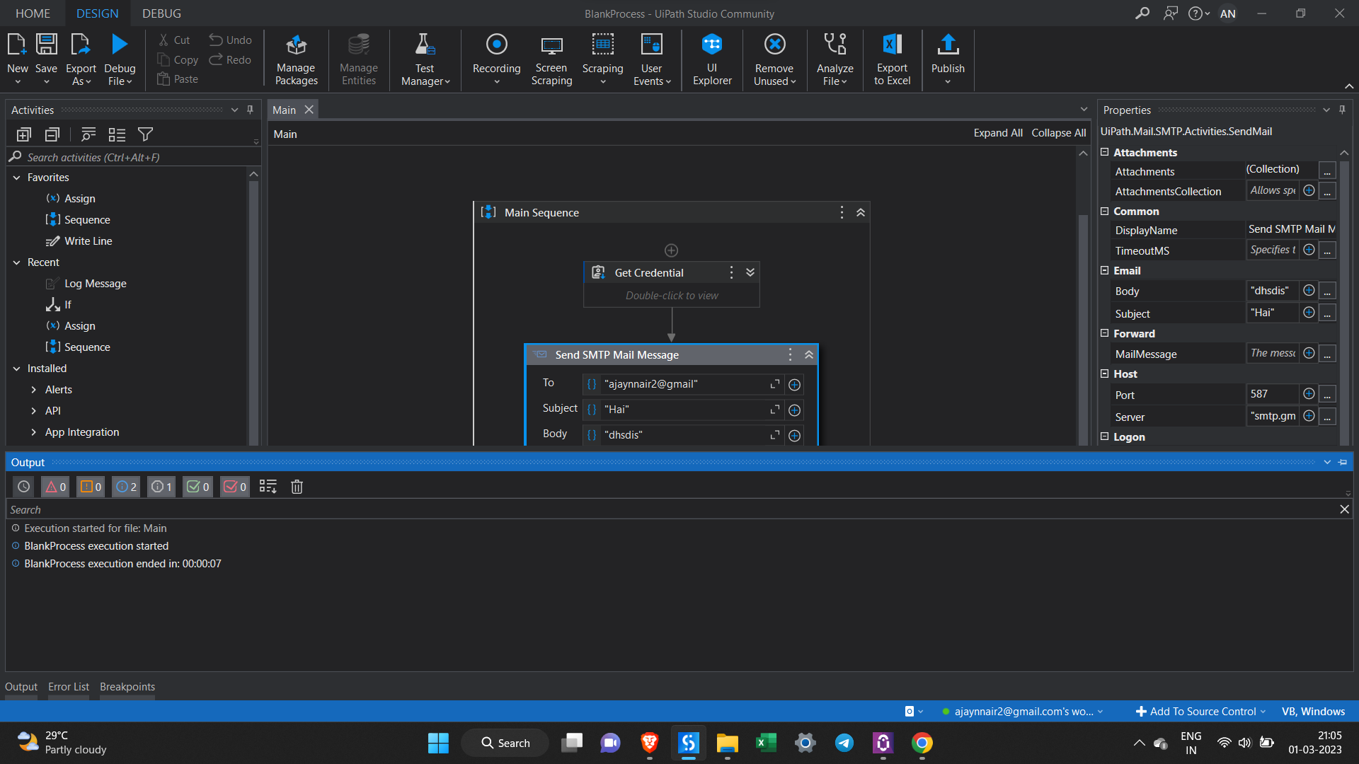

Send SMTP Issue
When i typed ajaynnair2@ in the To section of SMTP, process gets run eventhough mail is not correct and marked as successful in orchestrator.
How can i solve this because i have an excel file contains incomplete mails.
