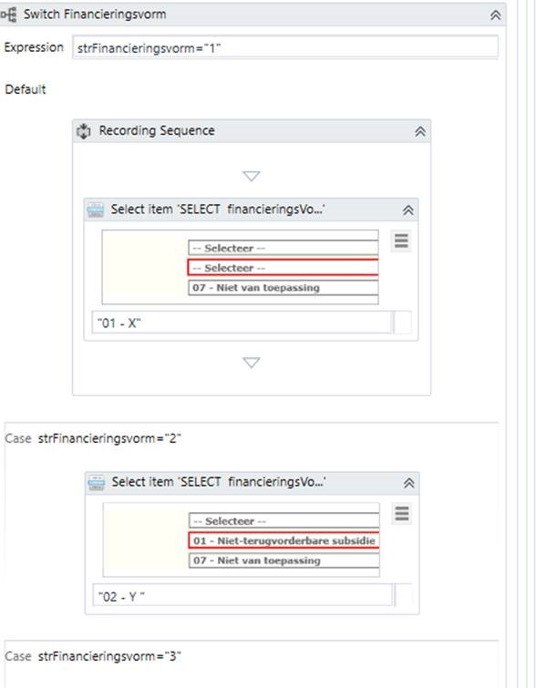

I have an excel datatable which contains 20 codes: 01 until 20. The value in the cell is stored as variable “Code”
Then, I have to enter this “code” on a webpage with a dropdownbox.
I found a way by nesting 20 if functions, but I bet there should be an easier way.
For example, if Code = 01 then select item “01. Location outside of EU”.
Thanks in advance,
Kind regards

Switch Case is much easier compared to Nested if.

Can give an example how I should use it in my case? Or do you have a sample .xaml already available by any chance?

Please refer the below link.
Thank you @SaranyaKishore,
It’s getting clearer. However, I’m still struggling a bit. the bot is not taking the correct value.
Is this how I should use it?
Thanks
Found the issue! Thanks a lot for getting me in the right direction!
