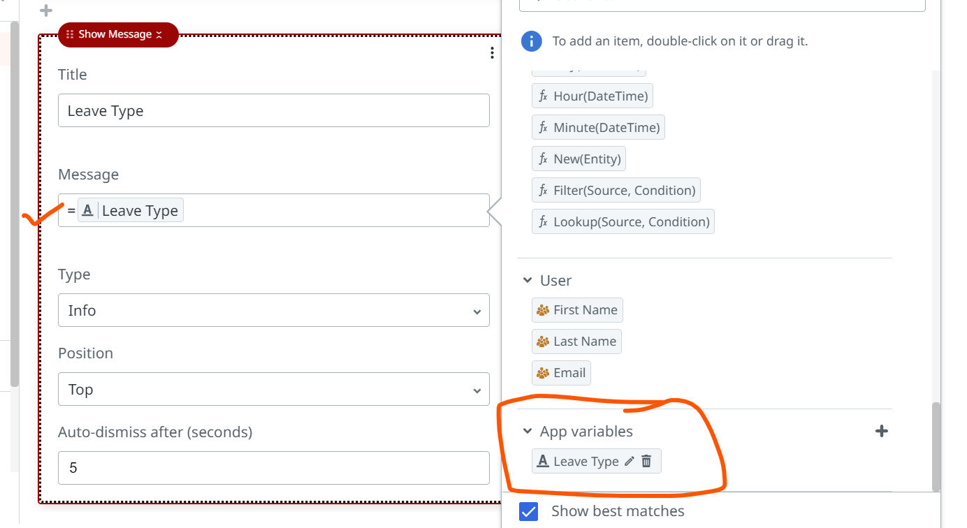

OK, Let me explain in other way, Please follow below approach.
  1. Create a App Variable.
  2. Add Data service entity with Apps
  3. Write a rule to Set value , wherever you want to do
  4. Use Lookup function to retrieve fist value based on condition
  5. Add show message to test and pass App variable in message.
I have an entity called Leave Type and I have assigned the app variable value with Set value rules. Please look at below screen shot.
Result
Thanks,
Arvind
