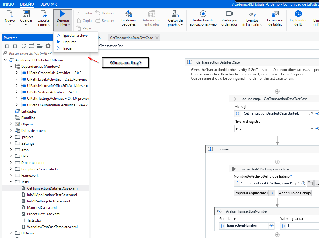

Hi Team,
Im trying to execute the test case with input data as excel file. While executing the test case, I don’t see the option “Run with Data Variations” to execute all the rows in the excel file. Can some one help?
Im using the 2024.10.0 community edition studio.
I can’t even see the “Test Case with Data Driven” option.

Its not disabled. I can’t see those options under the RUN button. Moreover, Im not changing the data source from Excel to Queue. It is only Excel.

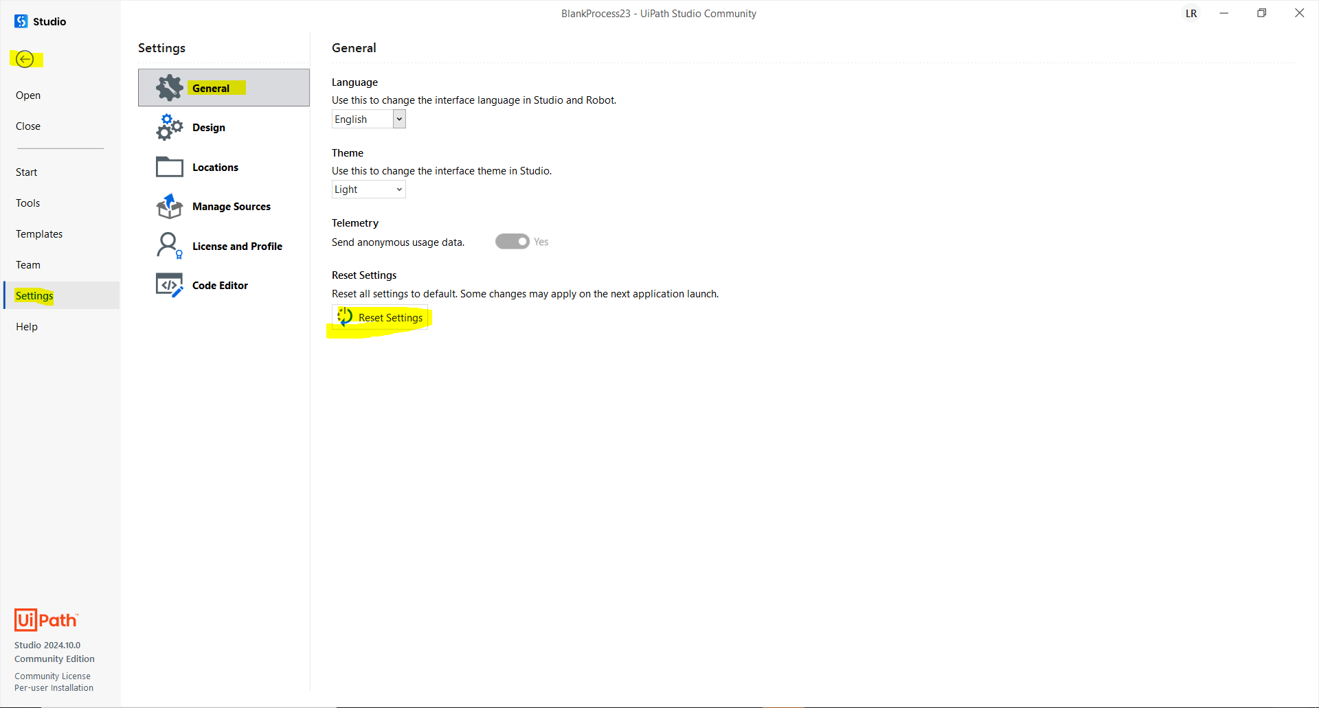

Hi @vishal_raghav
Can you try to Reset settings
No @Sai_chnadrika_Kopparapu , it didnt work.

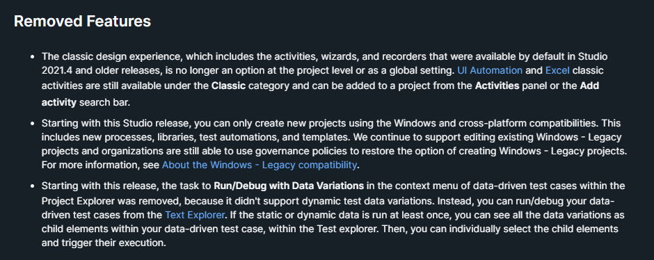

Its in the release notes. This isnt a bug or an issue but a different intended way of doing it.
I’m not a fan I think but there seems to be a technical reason for it.

you still can run all data variations or specific ones via Test Explorer.
pls refer to this thread for further detail:
