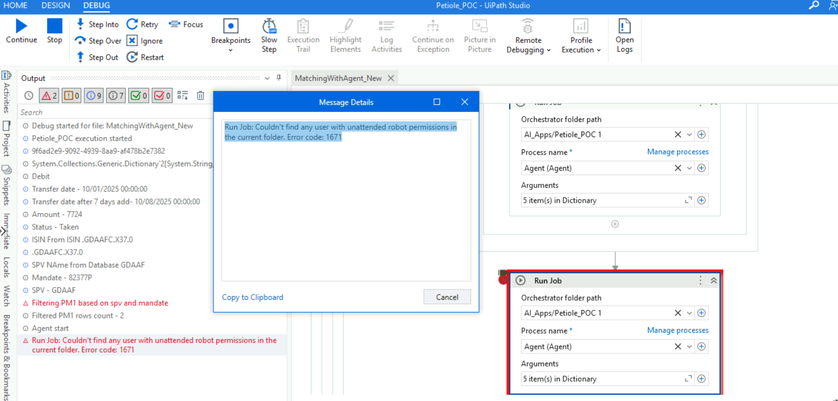

i am running job and getting error as
Run Job: Couldn’t find any user with unattended robot permissions in the current folder. Error code: 1671
below screenshot for reference pls help

You are missing unattended robot on the Orchestrator. Get unattended robot setup and you should be good.
This means that the folder you are running this process from doesn’t contain any robot account.
So add a robot account in that folder from orchestrator and you should be good.
Please note that if there is no robot setup already on orchestrator, then you will first need to create an unattended robot account there(follow video tutorial shared by @ashokkarale ) and then add it to the folder.

The error code 1671 means the user’s Unattended Robot cannot be found in that specific folder (Petrole_POC_1
Perhaps this is the problem:
The solution is usually found by linking the User and the Unattended Robot correctly within the Folder settings in Orchestrator.
