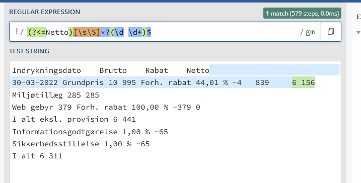

I need to get the last number, beneath “Netto”. In this Case 6 156. It will always be under “Netto” in the end of the line. I uploaded a picture to show how it looks.

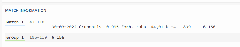

Give a try at following pattern:
(?<=Netto)[\s\S]*?(\d \d+)$
And refer to group 1
