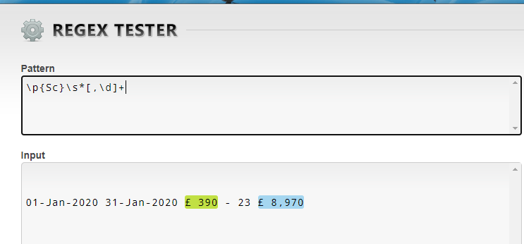

The date format will remain the same, I have tried the below, but it is matching two values, but I need only the last value
The Last amount value with the currency symbol, Yes alternative solution is acceptable.

Hi @mc00476004
You need to use dollar at the end of the pattern
—> \p{Sc}\s*[. \d]+$
(?<=\d+\s{1,2}-\s{1,2}\d+\s).*
check this pattern and let me know cheers!

Pradeep, This is working only for this string but if anything gets added in between this expression does not match. Thank you for your help bud!
I used this and this works perfectly fine
Hey Palaniyappan,
Thank you this works fine ![]()
