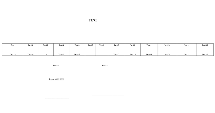

When i read a docx file (without Word Application Scope) and print result its look like this:
“\r\nTEST\r\n23\r\nTest15\r\n”
My task is to Replace “\r\n23\r\n” to another value. When i use DocumentReplaceText activity with Search value “environment.NewLine+“23”+environment.NewLine” or “vbCrLf+“23”+vbCrLf” or “chr(13)+chr(10)+“23”+chr(13)+chr(10)”, this values cannot be found. How can i solve it?

Thanks for your reply, in my case i should worry, because text can contain other “23” which should not be replaced, i need replace exactly this: “\r\n23\r\n”

Kindly note:
the origin file from you looks like:
the 23 is not surrounded by line break marks
So ^p23^p cannot detect the 23
search for only 23 will find also the others Test23, the Phone no
Unfortunately searhoption Whole Word is not available as we do have in Word
Fazit:
^p detect linebreaks
^p23^p is not the text present in the document
23 + whole word search option not abailble in activity
