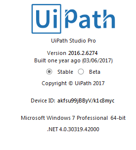

We are looking into it. Could you post a similar screenshot of your version from the Help menu?
You said that you work on 2016.3, but such version was never released (and we would need to know the version to debug the issue).
Please find the attached screen shot. Kindly tell what datatype of input and output needs to be selected during exccution.
