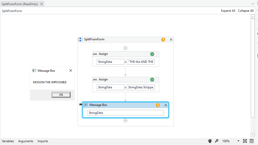

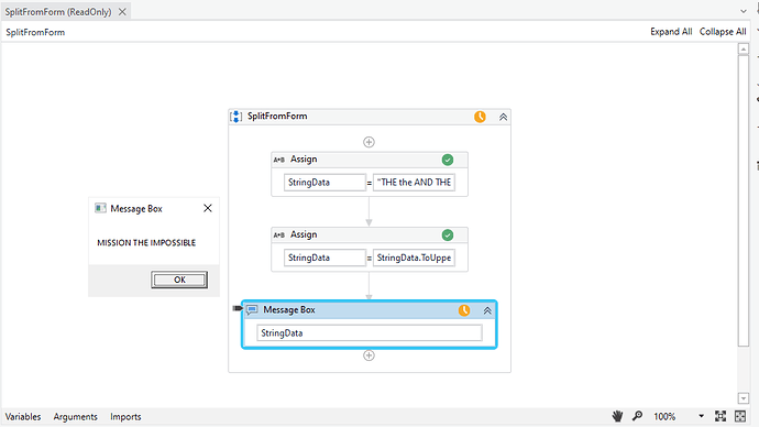

THE the AND THE MISSION THE IMPOSSIBLE
Expected Res: MISSION THE IMPOSSIBLE
Actual Res: the MISSION THE IMPOSSIBLE
THE the THE MISSION the and IMPOSSIBLE
Expected Res : MISSION the and IMPOSSIBLE
Actual Res: mission the impossible

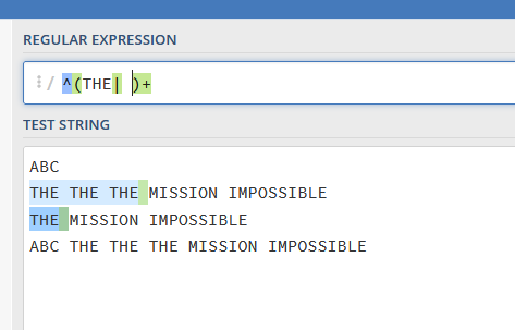

Question is any lines starts with
THE
THE THE
AND
AND THE
What ever the no of times or combinations of AND, THE comes it should be removed only should be retained including AND THE
