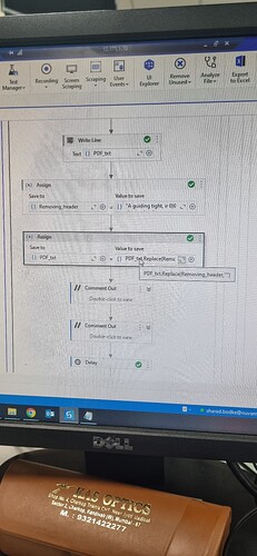

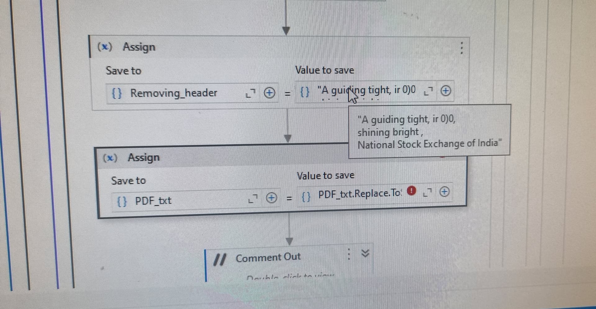

I have uploaded 2 images of my process one is from pdf and another is after extracting the pdf’s output
Above image is the header of new page in pdf i dont want that header after extracting the pdf and my read pdf activity is placed in loop so whenever the bot will get the header in new page of pdf it should not take that header…How can i do this?

@Nguyen_Van_Luong1 i cant due to company privacy.
PDF_txt = PDF_txt.replace(strHeader,“”)
can you try it
@Nguyen_Van_Luong1 i tried this then error has gone but it has not replaced that text.
@Nguyen_Van_Luong1
The activity got executed but it has not replaced that text.
I think your header it’s not correct
you can check it
other way is you can generate text after read pdf to data table
write to excel-> check it
remove all rows have value match header
