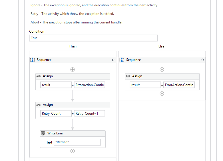

Hi all,
I’m looking for a way to set the number of retries = 0 for the global exception handler.
I have tried the below methods but it is still retrying:
Even by setting retry criteria to retrycount < 1,
Assigning retrycount = 100 to immediately exceed the limit
Setting both actions in the ‘If’ activity to errorinfo.Continue
The purpose of my global handler is to trigger a python script to run once it fails, I don’t need to retry the failed activity. Is this possible?

Thanks for your reply. This method still caused 3 retries to occur

Hi @Surya_Narayana_Korivipadu , I have attached a sample workflow that throws an error and then is still being re-tried by the global handler.
Thank you for the replies!
There’s a mistake in your global exception handler
Refer my previous post
you should use result = ErrorAction.Abort in the Then block of if condition, there’s no need to put any activity in the else block

Thank you @Surya_Narayana_Korivipadu , it works well now!
To understand better, was the main issue with my workflow setting result = ErrorAction.Continue that is causing the global handler to retry?
I realised when I set the RetryCount to be < 5, the handler will retry up to 8 times, does it mean using ErrorAction.Continue will cause it to retry 3 times minimum?
Yes. You’ve set result = ErrorAction.Continue. That’s the main issue.
I’m not sure why it retried 8 times. ErrorAction.Continue just throws the error once again, it will not retry 3 times. Instead of using your own variable Retry_Count, try giving errorInfo.RetryCount < 5 in the condition
