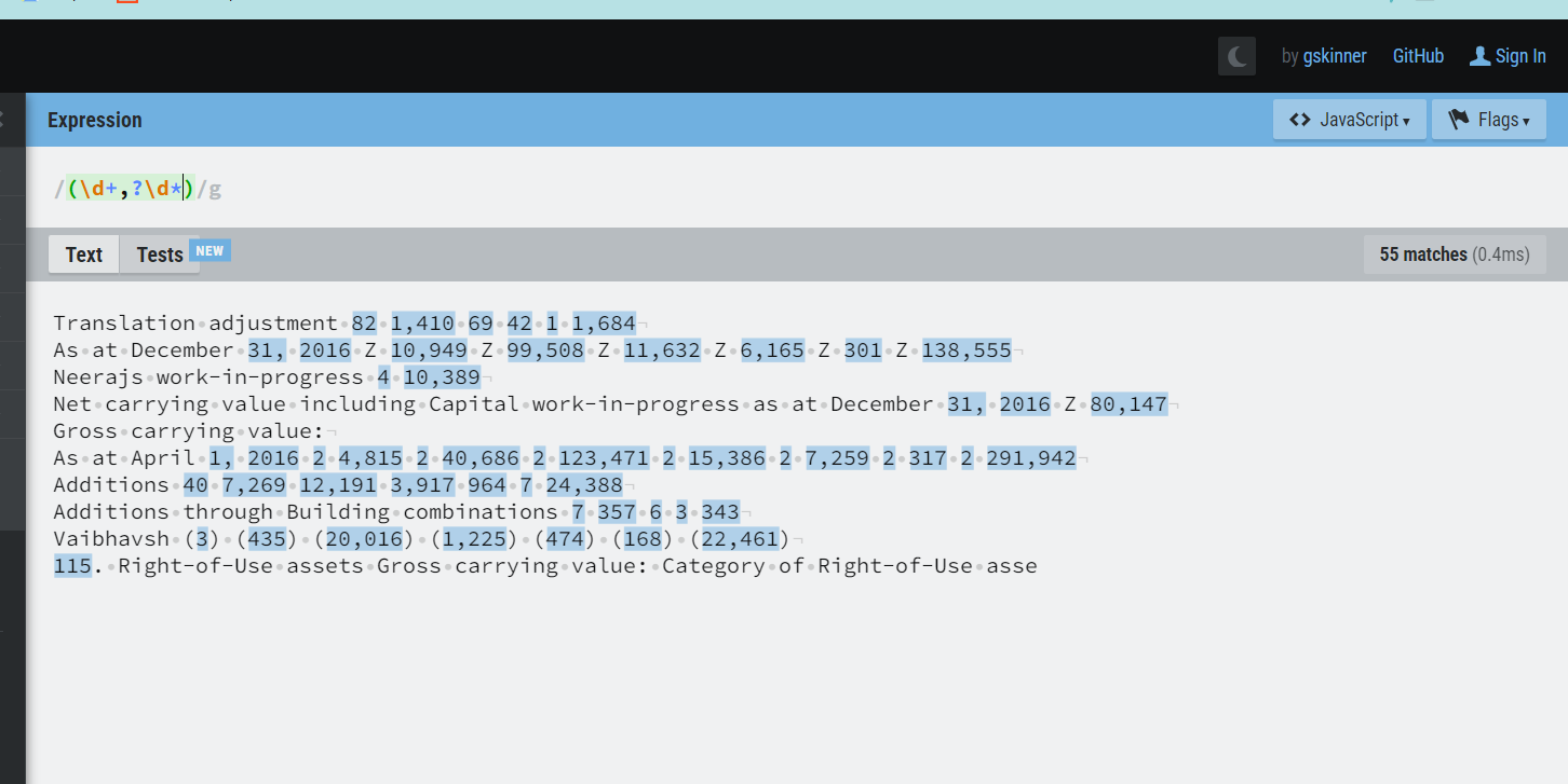

Regex–(?s)(?<=\b\bTranslation adjustment .?)(-?\d{1,4}(?:,\d{3})(?:.\d+)?|-|(\d{1,4}(?:,\d{3})*(?:.\d+)?)|\b\d{4}\b)(?:\s|\n)?(?=.*Right-of-Use assets|\d+,\d+$)

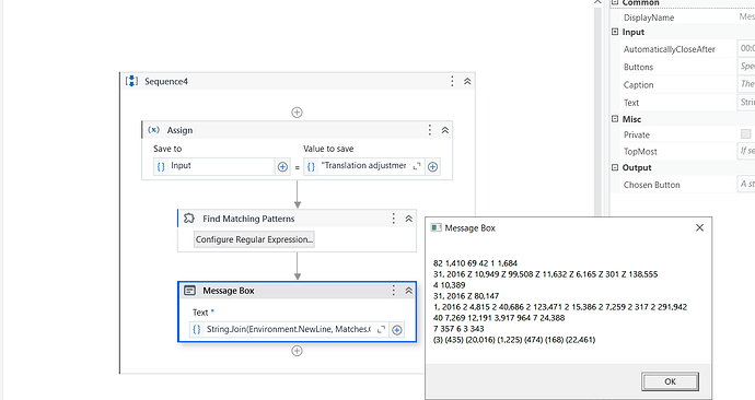

Sure, Here you go.
82 1,410 69 42 1 1,684
31, 2016 10,949 99,508 Z 11,632 6,165 301 138,555
4 10,389
31, 2016 Z 80,147
1, 2016 2 4,815 2 40,686 2 123,471 2 15,386 2 7,259 2 317 2 291,942
40 7,269 12,191 3,917 964 7 24,388
7 357 6 3 343
(3) (435) (20,016) (1,225) (474) (168) (22,461)
Maybe try out extracting data from this string line by line with the help of a for loop and using Split String to split this string into individual lines. Line by line will be better and more stable as per my opinion.

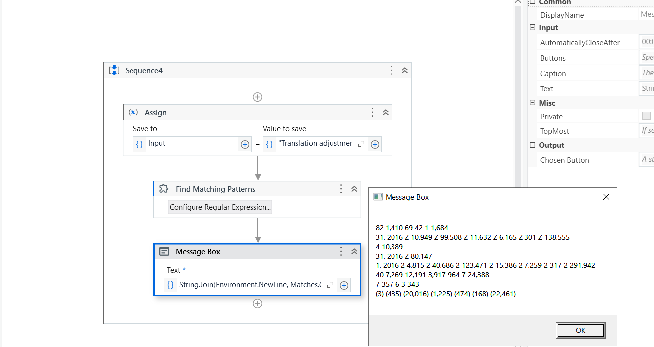

Try this:
Input = "Translation adjustment 82 1,410 69 42 1 1,684
As at December 31, 2016 Z 10,949 Z 99,508 Z 11,632 Z 6,165 Z 301 Z 138,555
Neerajs work-in-progress 4 10,389
Net carrying value including Capital work-in-progress as at December 31, 2016 Z 80,147
Gross carrying value:
As at April 1, 2016 2 4,815 2 40,686 2 123,471 2 15,386 2 7,259 2 317 2 291,942
Additions 40 7,269 12,191 3,917 964 7 24,388
Additions through Building combinations 7 357 6 3 343
Vaibhavsh (3) (435) (20,016) (1,225) (474) (168) (22,461)
115. Right-of-Use assets Gross carrying value: Category of Right-of-Use asset"
Regex Expression:

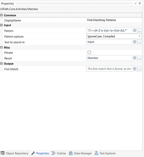

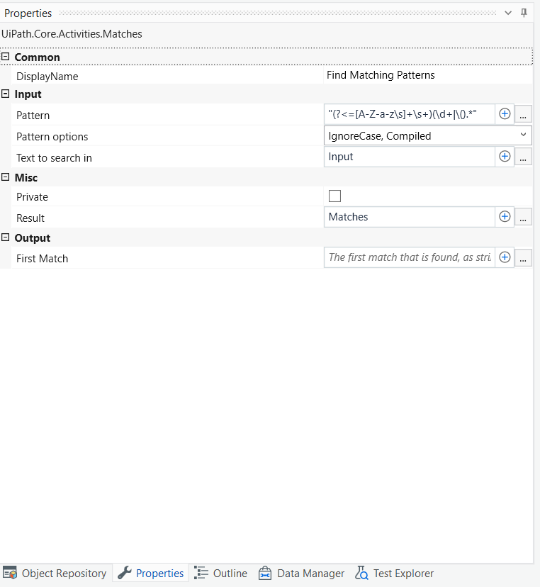

(?<=[A-Z-a-z\s]+\s+)(\d+|\().*
Properties of Find Matching Patterns
Hope it helps!!
Hello Parvathy,
Thanks for the response but here our requirement is that we are not getting data into the variable even after ‘find matching patterns’ activity is highlighting in the sample text which implies that the regex is working fine but there some other issue which we are not able to resolve.

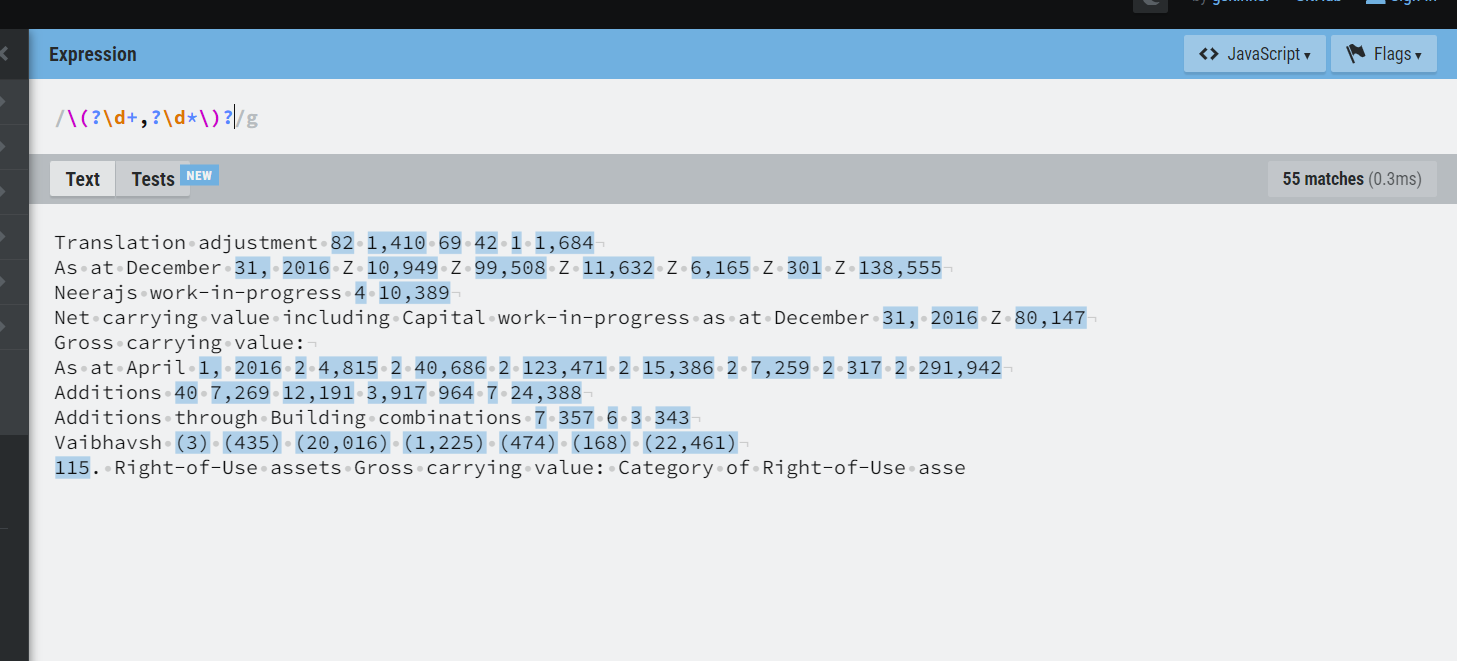

Also we used the below regex so that it will only pick numerals between 2 unique texts in the pdf and won’t take all the numerals of pdf.
Regex –(?s)(?<=\b\bTranslation adjustment .?)(-?\d{1,4}(?:,\d{3}) (?:.\d+)?|-|(\d{1,4}(?:,\d{3})*(?:.\d+)?)|\b\d{4}\b)(?:\s|\n)?(?=.*Right-of-Use assets|\d+,\d+$)
