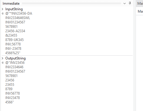

@Demo_User ,
Maybe you could also try with the below approach :
  1. Modify the Input String to remove the Special Characters at the beginning.
InputString = String.Join(Environment.NewLine, Regex.Split(InputString,"\r?\n").Select(Function(x)Regex.Replace(x,"^\W+","")))
  1. Next, we keep only the INV data upto end of the Number in it and data starting from Numbers upto the special character using the below expression :
OutputString = String.Join(Environment.NewLine,Regex.Matches(InputString,"(INV.*\d+)|^\d+",RegexOptions.Multiline).Select(Function(x)Regex.Replace(x.Value,"\W+","")))
Visual :
