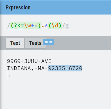

@Tanmay_V_Chetule
Try this
(?<=\w+ ).*(\d)

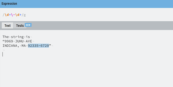

Use the below regex expression
System.Text.RegularExpressions.Regex.Match(YourInput String Variable,"(\d+\-\d+)").Value
Hope it works!!

@Tanmay_V_Chetule
System.Text.RegularExpressions.Regex.Match(“YourString”,“\d+-\d+”)
