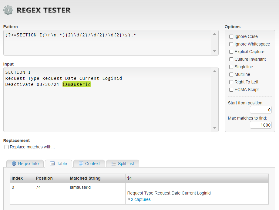

Hi @jamiejam - So you would like to extract the LoginID value which dynamic in the row underneath the section I? or the value "Iamuserid?

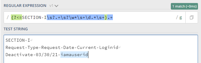

@jamiejam - Assuming there is no other data after IamuserID…you can try this pattern…
Pattern:
output = System.Text.RegularExpressions.Regex.Match(your_string,"(?<=SECTION I\s?.+\s?.+\s?\d{2}\/\d{2}\/\d{2}\s+).+").Value
Link: regex101: build, test, and debug regex
Or
output = System.Text.RegularExpressions.Regex.Match(your_string,"(?<=SECTION I\s?.+\s?\w*\s+\d.*\s+).+").Value

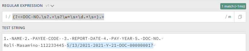

Good afternoon @Adrian_Star,
I am continuing to work on this automation and need assistance on another basic lookahead scenario. On a line in the PDF text I will get a distinct text value of
“DOC NO.”
On the ensuing line always at the end of that line a value will begin with Y-99 where 99 is a 2 digit number.
  1. NAME 2. PAYEE CODE 3. REPORT DATE 4. PAY YEAR 5. DOC NO.
    Roli Masamino 112233445 5/13/2021 2021 Y-21-DOC-000000017
I am trying to capture that value at the end of line 2. Either by the 4 digit year that precedes it or by the text pattern at the start. In either case it is always at the end of the next line. Your assistance is greatly appreciated. I am close with this and couldn’t quite get it.
You would like to capture the entire text as i highlighted above??
There are multiple ways to fetch it, Here I have anchored the date value
(?<=DOC NO.\r?\n?.+\d{1,2}/\d{1,2}/\d{4}\s\S+\s).+
