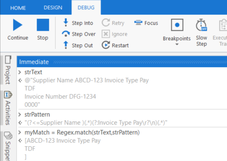

grafik
refering to group
grafik
result on prototype:
grafik
grafik
"(?<=Supplier Name )(.*)(?:Invoice Type Pay\r?\n)(.*)"
 String.Join("",{1,2}.Select(Function (x) myMatch.Groups(x).toString.Trim))
shifted to
grafik
