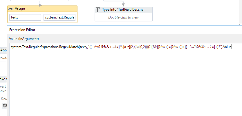

Hi @heena_shaikh
Try This Regex,
([–:\w?@%&+~#=]*.[a-z]{2,4}/{0,2})((?:?&=(?:\w+))+|[–:\w?@%&+~#=]+)?
Hope it works !!
@Krishna_547
It is not accepting the pattern.
@heena_shaikh
Use assign activity as shown below ,

Change the assign statement to below and try ,

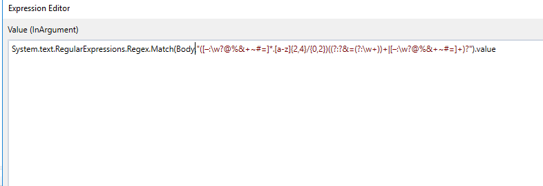

@Krishna_547,
Thanks Buddy it’s almost the solution.But it is capturing only the first dropbox link it come across, if there are 2 link it captures only the first one.
WHAT MODIFICATION I CAN DO FOR IT TO READ ALL DROPBOX LINK IN SINGLE MAIL
REGARDS,
HEEENA
Check this … StringReg will be an array of all matches … You can loop through that array list
New folder.zip (12.7 KB)
Now it is capturing the first link it come across rest it leaves
That is because of the write line… Use one more loop to loop through all elements of stringReg
As you can see it is not one link , they are two concatenated to one because of ,
StringReg(0).ToString + StringReg(1).ToString,
so use for each string of stringReg , and then print each one
