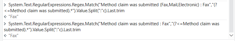

could you please try with below syntax-
System.Text.RegularExpressions.Regex.Match(“Method claim was submitted (Fax,Mail,Electronic) : Fax”,“(?<=Method claim was submitted).*”).Value.Split(":"c).Last.trim
It may be any string after ,“Method claim was submitted” above syntax will works.
as we are spliting with “:” and getting the last word
HopeItHelps…
